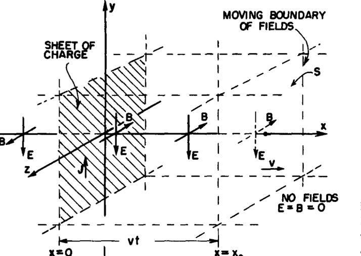

I am reading chapter 18 on Feynman's Lectures on Physics volume 2 (electromagnetism). It talks about how electric and magnetic fields can propagate in a free space.
Here is the situation: There's an infinite sheet of charge at the origin in y-z plane. Axis z points out of the page, x-axis points towards right, and y-axis points up. The attached figure will help understanding the situation.
Then the sheet of charge accelerates to a certain velocity towards positive y direction (upward) and maintains the velocity. There is also sheet of opposite charge at the origin to cancel any electrostatic effect.
Once the acceleration starts, B field is generated as such in the figure due to modified Ampere's Law (One of Maxwell's equations). While B is changing, there will be electric field generated due to Faraday's Law.
However, once the sheet of charge reaches a certain velocity, its velocity will stay constant, meaning although the B field generated due to Ampere's Law will be maintained, the E field generated due to Faraday's Law, (curl E = rate of change of B) will be eliminated due to the constant value of B.
The book, however, assumes that E field stays, taking a part in the electromagnetic wave propagating through space. I wonder if Feynman's assumption is wrong, or what prevents the E field being eliminated.
You seem to be under the mistaken assumption that a charged body moving at a constant velocity through an inertial frame has a static magnetic field. This is certainly not true. The magnetic field of a charged body moving at uniform speed can certainly have time dependence.
What does that mean, time dependence?
##\vec{\nabla}\times \vec{E} = -\partial_t \vec{B}## can only vanish if ##\vec{B}## is not a function of time. But the magnetic field of a charged body moving at uniform speed will in general have ##\vec{B}## as a function of time; the same goes for ##\vec{E}##. Just take any point in space; if the charged plate is moving towards that point and eventually away from that point then certainly the values of the electric and magnetic fields of the charged plate evaluated at that point have to change in time. The same logic applies to any other point in space.

Imagine that a charged object flies past you, traveling in a straight line at constant velocity. It approaches from a distance, e.g. from the east, passes a short distance in front of you, and then recedes into the distance in the west. You are holding magnetic-field and electric-field sensors.
The magnitudes of the fields registered by the sensors increase as the object approaches you, reach a maximum value when it is directly in front of you, and decrease as the object recedes from you. The direction of the electric field also changes.
For a generally accelerated charge you need the retarded potentials (Lienard-Wiechert potentials). For a charge moving with constant velocity you just need to do a Lorentz boost.
The four-potential for a point charge at rest can be written in the Lorenz gauge (in Heaviside-Lorentz units) as
[tex]A^{\mu}(t,\vec{x})=\frac{q}{4 \pi r} (1,0,0,0), \quad r=|\vec{x}|.[/tex]
Now for a reference frame, where the charge is moving with the constant velocity [itex]\vec{v}=v \vec{e}_1[/itex] we have [itex]x'^{\mu}={\Lambda^{\mu}}_{\nu} x^{\nu}[/itex] with the appropriate Lorentz-boost matrix. In components it reads
