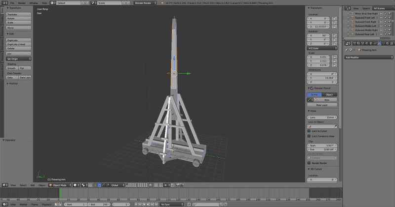

Summary:
Some help would be greatly appreciated for finding the ideal taper and x/y dimensions of a trebuchet throwing arm to optimize strength and minimize the moment of inertia.​
Long Version:
I am a high school junior currently in the process of working on an ambitious project to build a 21 feet tall trebuchet. I have recently built a 6-foot-tall model which successfully threw a baseball up to 80 feet with 55 pounds of counterweight. The issue now is that the next trebuchet, which is a hinged counterweight design, will require a large grant for all the hemlock wood and steel plates/axles that it will utilize. I need to prove that it will not break with a full counterweight of 2,000 pounds plus the weight of the trebuchet itself. The throwing arm will load back 135 degrees from vertical when it's in a ready to fire position. The main problem is regarding the throwing arm which is currently designed to by 4in by 12in by 15ft, but taper down to 4in by 6in at the top with 1/4" metal plates encasing the bottom. The short arm is 3ft and the long arm is 11.5ft to the base of the release pin. The counterweight box has not been modeled yet as I want to make certain the arm is structurally sound first. Ideally, the moment of inertia should be kept as low as possible along with the center of gravity to increase the release velocity of the projectile which will be a 16-pound shot put. What I have issues with due to my limited physics experience, is finding the optimal throwing arm dimensions for hemlock pine and the ideal taper for the arm to keep the arm lightweight, yet durable enough to survive a 2,000-pound launch. If anybody could help me out, I would be very grateful as I am unaware how to make an effective throwing arm on this scale.​
So, did you have a specific question? How much do you know about dynamics, kinematics, and stress analysis?
I basically want to know the ideal shape and size of a trebuchet arm for the given counterweight and short arm to long arm ratio. Ideal refers to a low moment of inertia, yet strong enough to survive repeated use. I'm in AP Physics C, so I'm aware of basic kinematics, but am at a loss regarding stress analysis which is vital for this problem.
First, since I have no background with these machines there are two issues I would need to understand for the determination of the arm loading stress and shape. The foremost is whether the launch restraint is at the end of the long throwing or on the load box end. If the restraint is connected to the load box then the maximum bending load on the arm will only be principally due to weight of the 16 lb shot put. The contribution by the arm will be the weight of the long section applied at the center of gravity of that section.On the other hand, if the restraint is connected to throwing end, then the applied static bending load on the arm in the latched position will be 2000 lbs plus the weight of the load box (which it seems to me will exceed all dynamic arm loading effects).
The other is the species of the hemlock wood you will be using, i.e. Eastern,Western, or Mountain, because the max shear failure stress varies considerably between the Eastern and both the Western and Mountain species. For example, assuming the wood you using is at 12% moisture, according to "Mechanical Properties of Wood" by David W. Green, Jerrold E. Winandy, and David E. Kretschmann" Chapter 4, the max shear stress parallel to the grain for those three species are respectively: 1060 psi, 1290 psi and 1540 psi.
