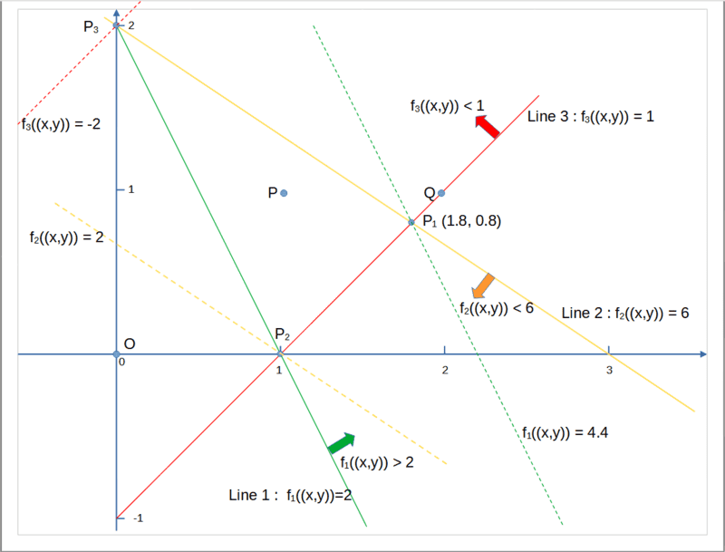

A triangle in the plane is formed by straight lines
##\left.\begin{matrix}
2x+y=2\\
2x+3y=6\\
x-y=1
\end{matrix}\right\}##
Which of the points P(1,1) and Q(1,2) lie in the interior of the triangle and which outside the triangle?
NOTE: No drawings or sketches are allowed as part of the solution.
I tried doing this problem, but couldn't find a solution that wouldn't involve a sketch... Finding the vertices was all I've got.

Okay so I have tried to work this out like you said, although a bit confused. Please correct me if I did any mistakes in here.
First rearranged the equations in the form ##y=mx+c##:
y= -2x+2\\
y=-\frac{2}{3}x+2\\
y=x-1
\end{matrix}\right\}triangle
Then, finding the vertices by equating all of the equations returns the 3 points:
A (0,2)\\
B (1,0)\\
C(\frac{9}{5}, \frac{4}{5})
Then, for example, for the first equation, ##y= -2x+2##, using the intersect between the other two lines, which is point ##C##, shows me that it must lie above the line and hence give the inequality ##y\geq -2x+2##
Thus, inserting point ##P(1,1)## into this inequality returns ##1\geq0##, which is ##\top##
I repeated this for all other inequalities, for point P, as well as Q. Point P was all ##\top## and some for Q were false, concluding that P lies within the triangle and Q outside of it.
I also checked the inequality symbols by inserting a point (0,0) to be sure. I am not sure if I have done this correctly, but that is all I could come up with. Please correct me.

I couldn't do this without using a sketch to justify the criteria. Eventually, we can perhaps state the purely algebraic criteria with confidence and who's to say that we needed a sketch to come up with the criteria in the first place? As long as you don't submit the sketch as part of your solution!
Let's take the two points we are given, ##P## and ##Q##, and add the origin ##O## as well to give us more data. Now, taking the lines in the order given, we plug in the ##x## value of our point and say whether the ##y## value is greater than or less than the expression in ##x## on the RHS:
For the point ##P(1,1)## we have: ##>, <, >##
For the point ##Q(1, 2)## we have: ##>, >, >##.
For the origin ##O(0,0)## we have: ##<, <, >##.
You could choose some other points inside the triangle or at locations outside the triangle and look at the three inequalities and see whether you can deduce a pattern for points inside and outside the triangle.

The values of the linear functions which determine the sides of the triangle ##a(x,y) = 2x+y-2##, ##b(x,y)=2x-3y-6##, ##c(x,y)=x-y-1## opposite to vertices A, B, and C, correspondingly, take at these vertices signs +, −, −. At the point P they take signs +, −, −, and point Q signs +, +, −. Therefore P belongs to the interior of the triangle and Q does not
Einstein44 said:
"Let's take the two points we are given, P and Q, and add the origin O as well to give us more data. Now, taking the lines in the order given, we plug in the x value of our point and say whether the y value is greater than or less than the expression in x on the RHS:"
I am not sure what to conclude from this
You can conclude that the point ##P## is above two lines and below one. The point ##Q## is above all three lines. And the origin is below two of the lines and above one.
Likes Einstein44
A triangle is a convex set. If you have the three vertices, then the point (1,1) is inside the triangle if and only if it is a convex combination (all coefficients are non-negative and sum to 1) of the vertices.
Likes Einstein44
Einstein44 said:
This is the solution:
Unfortunately I was not able to make sense of it, but perhaps it makes more sense now that I saw all the replies here.
Let's assume from this that the rule is that ##+,-,-## indicates inside and ##+, +, -## indicates outside.
My point in post #3 is that if we rewrite ##c(x, y) = -x + y + 1##, which should be equivalent, then this changes the signs of point ##P## to ##+, -, +##.
There must be an added stipulation that we write the linear functions in a standard form with a positive coefficient for ##x##. This is why I suggested writing the lines in the standard ##y = mx + c## format. In any case, we must have a defined, standard format.
However, even then, does ##+, -, -## always indicate inside for all triangles, or are there some triangles where ##+, +, -## indicates inside?

@Einstein44 I feel that this book is leading you astray, so I'll give you more of my analysis than I normally would for homework. Let's go back to my idea of using the format ##y = mx + c##.
Imagine a triangle with a horizontal base and area above the x-axis. It's clear that a point inside the triangle must be above the x-axis and below the other two lines. This would be a ##+, -, -## pattern.
If, however, we imagine the area below the x-axis, then the pattern would be ##-, +, +##.
What's clear is that the pattern of signs depends on the orientation of the triangle. We do not immediately know whether we are looking for ##+,+ -## or ##-, -, +##. It could be either.
I suggest, therefore, we also need to find a point definitely inside the triangle and test that. And see what pattern we are looking for. There are various ways to find one of those.
The book's method must suffer from the same problem that internal could be ##+, -, -## as in this case, but for a different triangle ##-, +, +## might indicate inside.
I'm also suspicious of a geometry teacher who asks you not to draw a sketch in this case, as all these algebraic ideas are essentially based on geometric ideas such as lines splitting planes into above and below. If the author did not sketch the problem, then I'm not suprised if they didn't fully grasp the possible solutions.

@PeroK sorry but you're wrong here. The exterior is not +,+,- the exterior is anything that doesn't match the single sign convention that defines the interior, so there are 7 sign patterns that all define the exterior. If you multiply both sides of the equation by -1, then you flip the sign of one of the defining inequalities, but that doesn't change anything. Whether any individual point satisfies the inequality is still the same.
Any polygon (or polytope in higher dimensions) is defined as the intersection of finitely many half spaces of the form ##<a,x> \leq b## for some ##a## and ##b##. If you have a > sign, multiplying both sides by -1 to turn it into a <, and absorbing the sign into your choice of a and b is standard.
@Einstein44 I'm happy to go into this in a bit more detail if it helps your understanding. Turning the equations into y=mx+b is especially not going to help your understanding when you start tackling higher dimensions.

The sign convention is a function of the equations that define the triangle. A triangle whose edges are ##y=1##,##x=1## and ##x+y=0## has interior ##y-1<0##, ##x-1<0##, ##x+y>0##.

Take the triangle defined by:
$$a(x, y) = y, \ b(x, y) = x - y, \ c(x, y) = x + y - 1$$And consider the interior point ##(\frac 1 2, \frac 1 4)##. The pattern is: ##+, +, -##, which is opposite to the ##+, -, -## pattern that indicated the interior of the triangle in the question. So, by some method, we have to establish the sign convention for the triangle in question.
The way you do it is by computing the vertices and checking each one against its opposite side.
It was said: "so there are 7 sign patterns that all define the exterior". In fact, the exterior of a triangle is described by 6 areas. Three are each adjacent to a side of the triangle; these are inside of two of the lines, but outside the third. Three are each adjacent to a vertex; these are inside of one of the lines, but outside the other two. What this means is that of the 8 possible sign patterns, 1 indicates the interior, 6 indicate the exterior, and 1 is forbidden. Which I find interesting. The forbidden area would be on the outside of all three lines, but this is geometrically impossible.
Likes Office_Shredder
Ah, good point.
  • #31
Einstein44 said:
Thanks very much for your input. I will try this problem again, this time with a better understanding!
The reason geometry is not allowed for this problem, is because this is not actually from a geometry class. This problem is from one of my modules on inequalities, sets and logic (to summarise).
I can't see how you could figure this out from sets and logic without having some geometric insight. I certainly could make no progress without a sketch. I think I understand the book's solution. We label the three lines ##A, B, C##, then the vertices opposite these lines ##V_A, V_B, V_C##.
Then, taking these in order: ##V_A## satifies the linear equations of lines ##B## and ##C## and we compute its value for the linear equation for line ##A##. We can call this function ##a## or ##a(x, y)##. We note whether its value is positive of negative. Then do the same for vertices ##V_B## and ##V_C##. The pattern we get in this case is ##+, -, -##. This is then the pattern we are looking for in the next step, which is to compute the three linear functions for the point in question. If we get the same pattern (in this case ##+, -, -##) it's an interior point. Otherwise, it's outside the triangle.
Unless this has been covered by your course (?) I don't see how you could figure this out for yourself.
  • #32
Neverthless, if we take my example:
$$a(x, y) = y, \ b(x, y) = x - y, \ c(x, y) = x + y - 1$$And consider the point ##(2, 1)##, we find that:
$$a(2, 1) = 1, \ b(2, 1) = 1, \ c(2, 1) = 2$$And, impossible or not, we have the ##+, +, +## signature!
  • #33
I think you're missing this conceptually. The impossible sign pattern for this, if I did the math right, is -,-,+. Because y<0 from the first one, the second one makes x<y<0, then the third one is the sum of three negative numbers so can't be positive.
Likes PeroK
  • #34
There's an 8th forbidden gluon state as well!
https://en.wikipedia.org/wiki/Gluon#Eight_colors
  • #35
I guess a neat fact, the impossible combination is sign flipped in every spot from the interior, which I guess is another way to figure out which one the interior is. It's not hard to deduce in the original problem that -,+,+ is the impossible combination.
