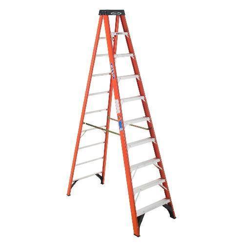

An isosceles-triangle-shaped ladder like the picture above, has a negligible mass. A man with mass m kg climb the ladder till the height is 3 meter (see picture above).
Determine the tension of the link (at horizontal position in the picture) between the sides of ladder.

The legs of the ladder are joined by the hinge at the top. The normal forces between the hinge and the legs of equal magnitude, and of opposite direction, but not sure if they are horizontal.
The man presses the ladder, but the normal force Nman acts on the man.
You have to write the equilibrium conditions separately for both legs of the ladder.

The system is not a single rigid body, so you need the FBD-s separately for all pieces.
The simplest is the man: its weight is counteracted by the normal force of the ladder step.
The two legs of the ladder are separate rigid bodies, but they interact at the hinge.
Draw the FBD for both legs. What forces act on the right leg, and what forces act at the left leg?

It is almost right now, but remove the force Nman. It acts on the man, not on the ladder leg. The opposite to Nman acts on the ladder, but it is equal to the weight of the man. And the two upward normal forces from the ground are not equal. Use different notations.
So, it's going to be like below, right ?
http://www.sumoware.com/images/temp/xzrqtoencmtbpebg.png
Yes, it is right now.
