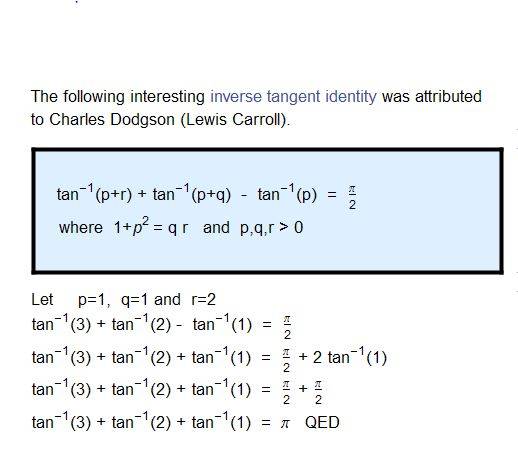

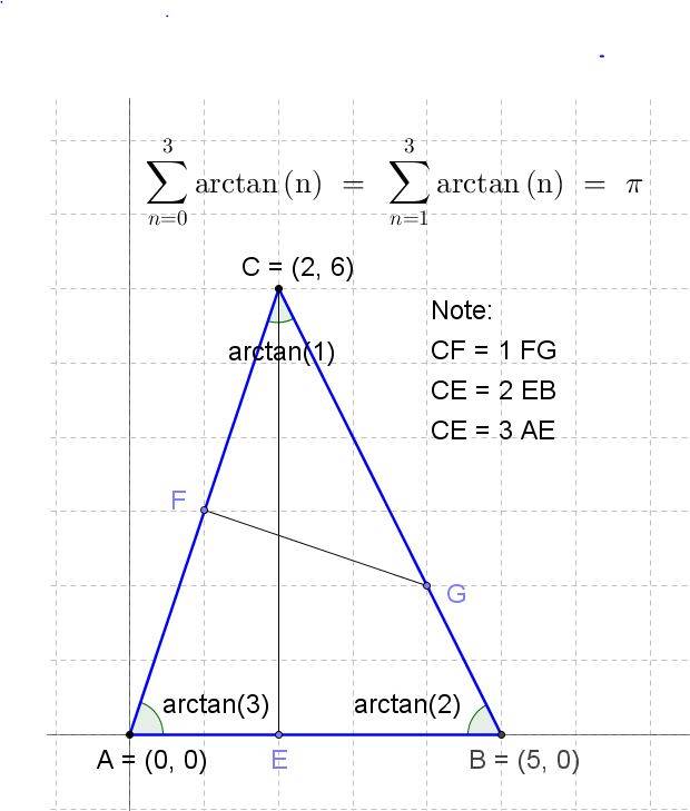

Do not ask me how to derive but the values are
1, 2,3
because i know
$\arctan(1) + \arctan (2) + \arctan (3) = \pi$
