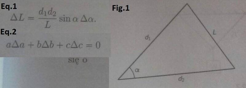

Deduce formulas:
a) how would change side L of triangle, when α angle changes slightly of value Δα for constant remaining sides of triangle i.e. d1 and d2 (fig.1)
b) in rectangular triangle all sides changes their dimensions slightly of values Δa, Δb ,Δc, where c is a hypotenuse. Proove the formula aΔa+bΔb+cΔc=0.
aΔa+bΔb+cΔc=0
ΔL=(d1*d2)/L*sinα*Δα
I'm confused about it is not clearly given in task that all the little changes Δ are approaching 0. Especially that Feynman does not mention limits in chapter exercise is for. He is using relatively big values as a little changes (like 4cm). Let's assume that Δ means value is approaching 0.

a) Are you familiar with the cosine rule?
L2 = d12 + d22 - 2d1d2cosα
b) To say that no change means no change is trivial and pointless. What we are interested in is a small but non-zero change, small enough that, although Δa itself is not negligible, (Δa)2 and higher powers may be regarded as negligible. Now, how do you apply Pythagoras to the modified triangle?
(PS Is the formula correct? E.g. if the triangle simply expands by 1%, Δa, Δb and Δc are all positive, so the formula can't be true. Is there some constraint you haven't mentioned?)

Equation in the b part of the question is different in my book. It is a(Δa) + b(Δb) = c(Δc) and it is easy to get with Pythagorean theorem. My question is how it is related with conservation of energy?

2) I guess there is a mistake and the OP meant to ask about aΔa+bΔb-cΔc=0.
