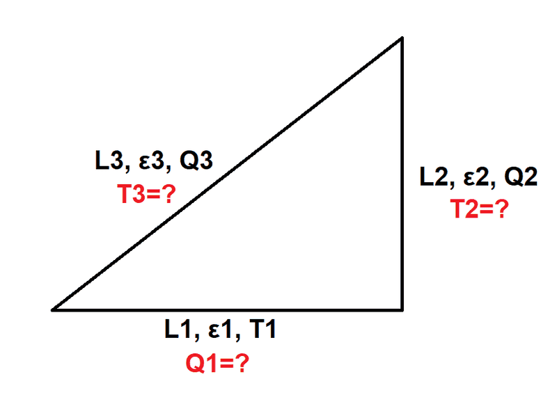

Hi,
I'm trying to solve a problem involving radiation in a triangular cavity:
As you can see, lengths and emissivities of all surfaces are given. For two of them, the heat flux is known and the temperature has to be found while for the remaining surface it's the other way around.
I have the numerical and analytical solutions for this problem, but I want to know exactly how to obtain the latter. Here's my approach, based on the book by A. Bejan: $$Q_{1}=\frac{\varepsilon_{1} \cdot A_{1}}{1- \varepsilon_{1}} \cdot \left( \sigma \cdot T_{1}^{4}-J_{1} \right)$$ $$Q_{2}=\frac{\varepsilon_{2} \cdot A_{2}}{1- \varepsilon_{2}} \cdot \left( \sigma \cdot T_{2}^{4}-J_{2} \right)$$ $$Q_{3}=\frac{\varepsilon_{3} \cdot A_{3}}{1- \varepsilon_{3}} \cdot \left( \sigma \cdot T_{3}^{4}-J_{3} \right)$$ $$J_{1}=(1- \alpha_{1}) \cdot \left( (J_{2} \cdot F_{12})+(J_{3} \cdot F_{13}) \right) + \varepsilon_{1} \cdot \sigma \cdot T_{1}^{4}$$ $$J_{2}=(1- \alpha_{2}) \cdot \left( (J_{1} \cdot F_{21})+(J_{3} \cdot F_{23}) \right) + \varepsilon_{2} \cdot \sigma \cdot T_{2}^{4}$$ $$J_{3}=(1- \alpha_{3}) \cdot \left( (J_{1} \cdot F_{31})+(J_{2} \cdot F_{32}) \right) + \varepsilon_{3} \cdot \sigma \cdot T_{3}^{4}$$ where view factors are calculated from the following formulas: $$F_{12}=\frac{L_{1}+L_{2}-L_{3}}{2 \cdot L_{1}}$$ $$F_{13}=\frac{L_{1}+L_{3}-L_{2}}{2 \cdot L_{1}}$$ $$F_{31}=\frac{L_{3}+L_{1}-L_{2}}{2 \cdot L_{3}}$$ $$F_{21}=\frac{L_{2}+L_{1}-L_{3}}{2 \cdot L_{2}}$$ $$F_{23}=\frac{L_{2}+L_{3}-L_{1}}{2 \cdot L_{2}}$$ $$F_{32}=\frac{L_{3}+L_{2}-L_{1}}{2 \cdot L_{3}}$$
The problem is that the software that I use to solve this system of 6 equations for the 6 variables ##J_{1}##, ##J_{2}##, ##J_{3}##, ##Q_{1}##, ##T_{2}## and ##T_{3}## doesn't give any solution so I assume that something is wrong with my equations. Do you know where I made the mistake in the calculations? Maybe I misinterpreted the formulas from Bejan's book. They look like this: $$Q_{i}=\frac{\varepsilon_{i} A_{i}}{1- \varepsilon_{i}} \cdot \left( \sigma T_{i}^{4}-J_{i} \right)$$ $$J_{i}=(1-\alpha_{i}) \sum_{j=1}^{n} J_{j}F_{ij}+ \varepsilon_{i} \sigma T_{i}^{4}$$ for ##i=1,2,...,n## where ##n## is the number of surfaces in a cavity. $$F_{ij}=\frac{L_{i}+L_{j}-L_{k}}{2L_{i}}$$
[EDIT] I've resolved a bug, in the R matrix i used -1 instead of Q2 and Q3[/EDIT]

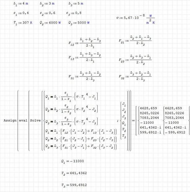

Now it also works in the other software in which I was trying to solve the initial, incorrect system of equations.
In fact, what confused me is this sentence from the referenced document:
Substituting this expression for the view factor into the second equation for the heat fluxes results in a linear system of six equations.
I thought that just the second equation for heat flux is needed to obtain the system of 6 equations and I was wondering how they did that so I reached for Bejan's book referenced by them and used the equations from it. Apparently, they are too general or not adjusted for this case.
So now I'm curious what other software you used to solve the equations :)
It's SMath Studio - free (but with some limitations like the limit of 3 devices per account introduced to new versions) equivalent of MathCAD. However, to solve this system of equations I had to use the Maxima plug-in for SMath. Maxima is open-source and truly free CAS software similar to Mathematica. It has its own GUI (wxMaxima) but SMath adds handling of units and a much more user-friendly display of formulas.
Unfortunately, I had to suppress the units for the equation since the software reported some inconsistency of units (there can be issues with temperatures sometimes).
Likes Arjan82
