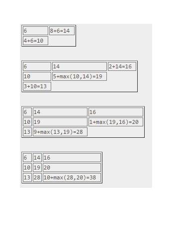

Notice that to visit a minimal number of houses, it necessitates that you either travel east or south from one house to the next until you arrive at the party. To obtain the maximum treats, track the current maximum as you visit each home. Example:
The final value obtained at the party will be the maximum amount of treats.

I have a problem with the above code but I can't seem to find the problem. When I entered Sample Run #1, the output was 34 instead of the desired 38. May I have some guidance on what is wrong with my above code?
Thanks! :D
Without even trying to analyze the code: try to run you algorithm by hand first, and then compare what the program really does running it under debugger. That's a method that always help find where things go not as expected.
