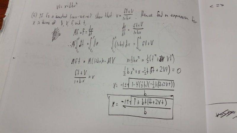

A comet in deep space picks up mass as it travels through a large stationary dust cloud. It is subject to a gravitational force of magnitude Mf acting in the direction of its motion. When it entered the cloud, the comet had mass M and speed V. After a time t, it has traveled a distance x through the cloud and its mass is M(1+bx), where b is a positive constant and its speed is v. In the case when f is a non-zero constant, show that [tex]v = \frac{ft+V}{1+bx}[/tex]
and hence find an expression for x in terms of b, V, f, and t. Then show that it is possible for the comet to move with constant speed.
Differential equations of motion for kinetics, force is rate of change of momentum (Newton's second)

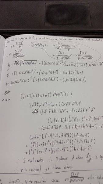

So right off the bat I'm pretty sure this doesn't make sense because if the comet were to gain mass the force of gravity would change i.e. it wouldn't remain Mf. But disregarding that, my main issue is proving that the comet can move with constant speed. I know the acceleration should be shown to be an equation that has roots, but it seems pretty messy. Sorry if the solution just really is messy, but I have the feeling there's something I'm missing. Anyway, here's what I've tried:
[/B]
Both velocity and mass are functions of time. What does this do to your expression for ##\frac{dp}{dt}##?
[EDIT]: On second thought, this problem is ambiguous. Is M a constant? I was assuming it was the mass of the comet as a function of time (which would make sense). Otherwise I don't think there's a simple solution.
Likes lowea001
Yes M is a constant, its initial mass, but its mass is always changing and at any position x is M (1+bx). Therefore gravity remains constant according to the wording of the question I.e. dp/dt is a constant fM (I know it doesn't make sense but if you replace gravity with contant force it does). Integrating both these with respect to time yields the thing we're trying to show. But assuming that this thing is right, how would I show that it has the potential to be constant? Is the only way to differentiate v after finding x and seeing if the acceleration can be zero?
Ah, I see. I was making this much harder.
What do you get when you differentiate v? Try to avoid substituting your big clunky expression for x.
Likes lowea001
Oh don't put in the expression for x? If I partial differentiate the expression with respect to time is that still the acceleration regardless of x? Or can I just treat it as a constant somehow? (Sorry I'm a calculus noob).
Yes. Differentiate ##v## with respect to ##t## and set the expression equal to zero. But instead of plugging in your expression for ##x##, just notice that ##x = x(t)## and ##\frac{dx}{dt} = v##. You're looking for an expression for ##v## that only contains constants.
Likes lowea001
Thank you so much! Finally figured it out.
Also, just out of interest, apparently as t -> infinity, v -> a constant. Sounds fun, but how can I show that?
To get the actual constant, you'd plug the expression for ##x(t)## into the expression for ##v## and take the limit as ##t \rightarrow \infty##. If you just want to show it, it's probably enough to notice that ##x \propto \sqrt{t^2} = t## and then look at the behavior of the limit from there.

[tex]
v = \frac{ft + V}{1+bx} \ (1) \\
Using \ quotient \ rule \ and \ asserting \ acceleration \ can \ be \ zero: \\
\frac{dv}{dt} = \frac{f(1+bx) - \frac{dx}{dt}(ft+V)}{(1+bx)^2} \\
0 = \frac{f}{1+bx} - \frac{bv(ft + V)}{(1 + bx)^2} \\
0 = \frac{f - bv^2}{1 + bx} \\
0 = f - bv^2 \\
v = \sqrt{\frac{f}{b}} \ (a constant) \\
\\ Also: \\
x = \frac{\sqrt{1 + bt(ft+2V)} -1}{b} \ (2) \\
[/tex]
If acceleration is non-zero, according to equation (1) and (2) (the latter is found by separable d.e.):
[tex]
\\v = \frac{ft + V}{\sqrt{1 + bt(ft +2V)}} \\
v^2 = \frac{(ft+V)^2}{1 + bt(ft +2V)} \\
v^2 = \frac{f^2t^2 + 2ftV + V^2}{bft^2 +2Vbt + 1} \\
Dividing \ numerator \ and \ denominator \ by \ t^2 \ and \ taking \ the \ limit \ as \ t \ approaches \ infinity: \\
v^2 = \frac{f^2}{bf} \\
v = \sqrt{\frac{f}{b}} \ (as \ t \ approaches \ infinity)

I agree with your result for the final v.
But you did not need to solve a differential equation to get this! So understand how you could have got it more easily. Just draw a diagram of this behaviour and you will probably see.

It is a valid method of obtaining the final velocity, but it remains true that as a method of calculating final velocity it is all unnecessary and it can be done in one line as I have hinted.
If eq.(2) is meant to represent x at all times, I think it is not right and is obtained by an invalid argument. So far as I can understand, the final velocity is obtained, and then this is fed into an equation to obtain the velocity at other times, which cannot be right.
