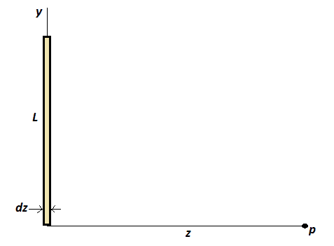

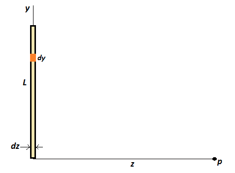

You could try breaking the rectangular area into vertical strips of infinitesimal width. So, you might first want to solve the problem of the electric field at a point p on the x-axis a distance z from one of the strips.
Define a surface element ##dS## at position ##(y,z)## charge ##\sigma dS##
Then you are integrating over y and z as well as accounting for the out-of-plane displacements.
As TSny suggests, it can be easier to work out the strips first.

Alright, here's what I have so far.
For the E-field at p due to a 'representative strip' as you guys advised, I have
Eline = kλ∫(y2+z2)-1/2dy (this is a definite integral, from O to L, and λ is the constant linear charge density).
Then I need to integrate that over the horizontal (z?) axis from -w to 0:
Etotal = ∫[∫(y2+z2)-1/2dy]dz
Where the first (outer) integral has limits -w to 0 and the inner has limits 0 to L.
Am I on the right track here? Thanks for your help!

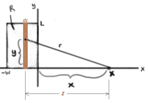

Here is how I was interpreting the quantity "z". It's just the distance from a strip to the point of observation. Note z is never 0. What are the minimum and maximum values of z?
You need to set up separate integrals for the x and y components of E.

I probably should have used a symbol different from z. Feel free to change it to whatever you want.
Since z is used in the problem statement for a coordinate axis, it is not surprising TSny's use confused you.
The trick to doing these things is to go one step at a time and be clear at each stage about what you are dealing with. It helps if you are thinking geometrically rather than in terms of finding equations to put numbers into.
Try using the notation in post #13.
Explore the brute-force approach first, since you are having trouble with the geometry.

This looks very good. Write dq in terms of the area of a small piece of a strip.

The reasoning follows the same approach - put the observer at ##\small (x_0,0,0)## to distinguish from the coordinates you are to integrate over.
Then the element at ##\small (x,y,0)## : ##\small 0<x<-w, 0<y<L## has area ##\small dxdy## and charge $$dq=\frac{Q}{wL}dxdy$$
You don't understand why that is?
You are given a surface of area A=wL (width times height) that holds a total charge of Q.
Therefore - what is the charge density?
[edit: you got it! Well done.]
You need this because you need to know the field due to a small element of charge dq that occupies the infinitesimal area dxdy. This replaces the point charge that you first learned to use.
The electric field is given by: $$d\vec{E}=\frac{kdq}{r^3}\vec{r}$$ where ##\small \vec{r}## points from ##\small (x,y,0)## to ##\small (x_0,0,0)##
You'll end up with an equation in terms of ##\small x_0## instead of x. Don't worry about that just yet.
[edit]OTOH: if you are following TSny again and it now makes sense - just keep going. ;)

Right. But since I forced you into writing the width of a strip as dz, you will want to write it as dq = (Q/wL)dydz.
As Simon says, "this is fun".
Using dq = (Q/wL)dzdy, this gives me for my integral (I'm using the z variable as defined by TSny)
E = kQ/(wL)∫1/(y2+z2)3/2(z e1 + y e2)dzdy
(Sorry it's so ugly!)
The integral is clearly a double integral, and I'm thinking the integration limits for dy are 0 and L, while the integration limits for dz are x and x + w, since x ≤ z ≤ x + w.
(x being the horizontal distance from origin to point of interest.)
