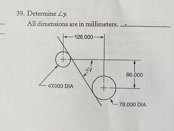

Trig help please! CNC Machining/Engineering

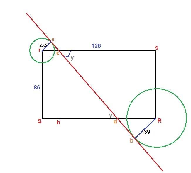

I redraw the picture. you mean by DIA ( diameter ) right ?. you can notice that the two triangles the one with the big circle and the one with small circle are similar.
$dR = \frac{39}{\sin y}, cr = \frac{23.5}{\sin y}, ch = \frac{86}{\tan y}$ now
$dR + cr + ch = 126 $ hence
$126 = \frac{39}{\sin y} + \frac{23.5}{\sin y} + \frac{86}{\tan y} $
$126 \sin y = 62.5 + 86 \cos y $

Yes DIA means the diameter...

you mean ch ? it is typo I meant $dh$. ch is perpendicular to SR so we have a right triangle $\tan y = \frac{86}{hd} $
$hd + dR + cr = 126$

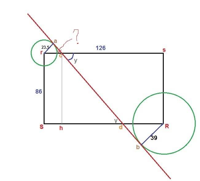

Yes sorry HD...Initially I though 126-39-23.5 but there's a little gap between the circle, do you see?
- - - Updated - - -
- - - Updated - - -
Actually...gap next to big circle too! :-\
yea I see it but it dose not affect the solution. "c" is the intersection between the tangent and the horizontal line "rs". and "ra " is perpendicular to the tangent it is a theorem the angle $acr = y$ I used sine definition to come up with $\sin y = \frac{23.5}{rc} \rightarrow rc = \frac{23.5}{\sin y}$
