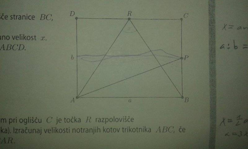

ok so my professor gave me this problem to solve, it goes like this :(I will also have a picture below)
In the square (ABCD) is a point P which divides the side BC into 2 halves and point R which divides the side CD into 2 halves
The angles at APB and ARB are the same.
Calculate the angle x and the ratio of sides of the square
2. Homework Equations
he gave me an answer x=arc tan (2*sqrt(2))
and
a:b=sqrt(2):1
I got those answers but I also got a second one and I an wondering if you guys can tell me why the 2nd answer is not possible

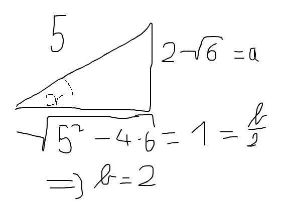

so know I finally returned to my initial equation
sin(x)=2a/sqrt(4a2+b2) and I put in b2
sin(x)=2a/sqrt(4a2+a2/6)
sin(x)=2a/sqrt(25a2/6)
sin(x)=2a*sqrt(6)/5a
sin(x)=2*sqrt(6)/5
and if I draw this triangle i can figure out the 3 side
and then I can calculate the angles as
tan(x)=(2*sqrt(6))/...x=arc tan (2*sqrt(6))
and
a:b=sqrt(6):1
can somebody help me find my mistake or tell me why this is not a possible answer ?

I can't tell your mistake bc I'm having trouble following your reasoning.
You check answers by drawing out the resulting rectangle and checking the angles etc make sense. This approach also helps you understand what happened.
I'd have divided side AB in two, labelling the halfway point Q
Then I'd use the tangent definition on the triangles ABP and RQB
... the tangent half-angle formula looks useful here.
Likes Matejxx1
Your approach allows the angle ARB greater than 90°, as you work entirely with sines. But the angle APB has to be less than 90°. The tangent of half of the angle ARB is a/(2b) and a/(2b)<1 must hold, that is a/b<2. Working with the half-angle formula as Simon suggested you get only a=√2 b. If you assume a=√6 b, you get negative value for the tangent of angle ARB, although its sine is the same as that of APB.
Draw also the triangle ABR.

Thank you
just to check if I really get it
if I would allow that the tangent half angle at ARB is >1 than that would mean that the whole angle would be over 90° and since the picture only shows the posibility of the angle being less 90° the second solution is ruled out.?

Yes, correct.
