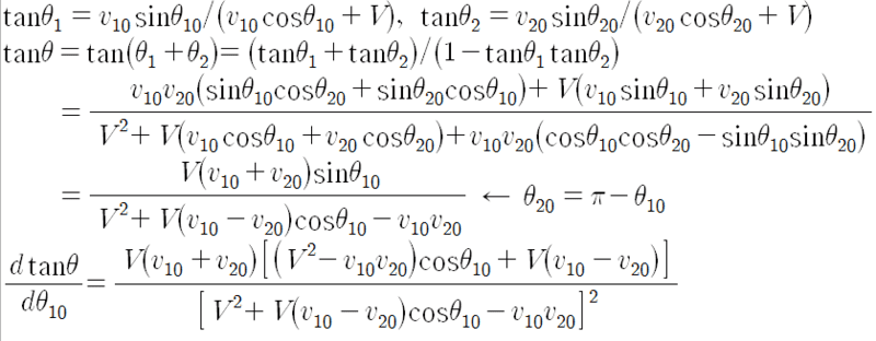

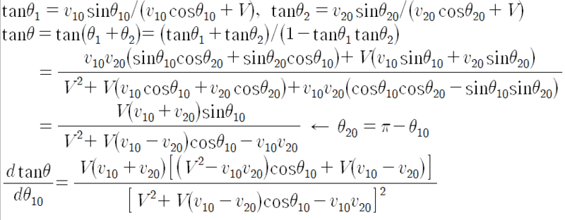

So I calculated the tangent of θ and derivative of it
But I can not calculate the extrema, thus I can not solve it...
How to do calculate the extrema?

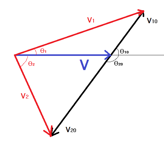

The problem is
Determine the range of possible values of the angle θ following the figure.
Can't be the full problem statement. And: there is no ##\theta## in the fgure.
in description θ = θ1 + θ2
and θ10 + θ20 = π
What particle are we looking at ? What's its energy before decay ? What are the decay products ? etc etc etc
In C system, total momentum is 0
it is just m1v10+m2v20 = 0
In L system, v1=v10+V, v2=v20+V, and total momentum is not 0
The particles we looking at are in L system.

To get the extrema you need to solve for ##\theta_{10}## from ##d \tan(\theta)/ d \theta_{10} = 0##. I have not checked your algebra, but assuming your final expression is correct, this condition simplifies to
$$ (V^2 - v_{10} v_{20}) \cos \theta_{10} +V(v_{10} - v_{20}) = 0$$ You can express the answer in terms of ##\arccos \theta_{10}##.

What's your tanθ?
I also used algebra program but the result is same as my calculation
physicophysiology said:
What's your tanθ?
Sorry: you are correct! I changed the notation but neglected to change the equation for the angle ##\theta##. When I correct that error, I end up getting exactly the same result as you.

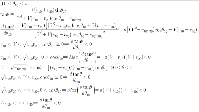

How to calculate the extrema?
for example, When v10 < V < v20
From d(tanθ)/dθ10 < 0, how can get the solution 0 < θ < π ?
I can get it only when V2 = v10v20
I have just solved it completely thanks everyone
