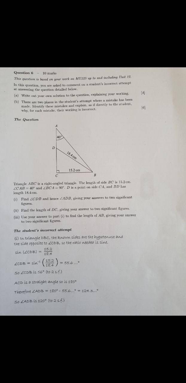

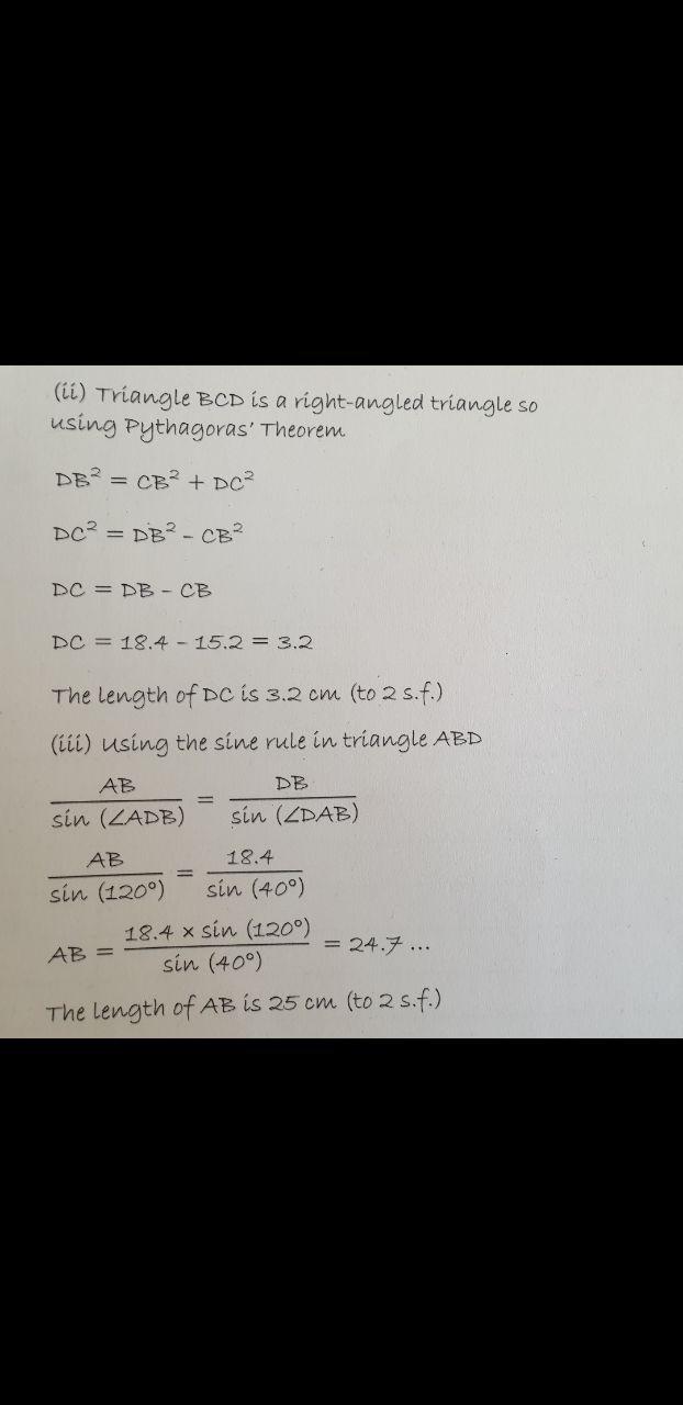

part (i) of the student's response is correct.
part (ii) has an algebra error in determining the length of DC
if $DC^2 = DB^2 - CB^2$, then $DC \ne DB - CB$
the trig for part (iii) is correct ... can't say I agree with using 120 degrees for angle ADB since it induces rounding error in determining the length of AB.
Using the equation $\sin(40) = \dfrac{BC}{AB} \implies AB = \dfrac{BC}{\sin(40)}$ will not induce that error.
