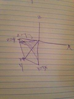

I don't want to just guess so first i want to make sure my picture is correct. This is what I have drawn:
Normally we draw xyz graphs in a right handed coordinate system, unlike your picture. Using your picture, the question would be what is x on the left and x on the right, on the surface, not the xy plane.
it wouldn't be from 0 to y/2? or wait that would only be on the xy plane? so it would be from 0 to (1/2)sqrt(y^2-z^2)
Bingo! And your y and z limits you had gotten from the yz plane are correct.
