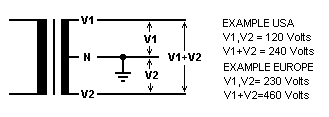

how are the wires wrapped on a transformer that converts from triple phase power distribution to split phase outlets?
All you need is one phase to make a split phase.chopficaro said:how are the wires wrapped on a transformer that converts from triple phase power distribution to split phase outlets?
http://www.powertransformer.us/polemountedtransformers.htmOutside a typical house you can see a pole mounted transformer mounted on the electricity pole. It's a step-down transformer used to convert the high voltage (7200 or 14400 volts) down to the standard 120/240 volts used in the home. The high voltage distribution lines (7200 or 14400 volts in the US) attach to the two bushings on top. The low voltage wires (two hot wires and one neutral) attach to the three terminals on the side. The secondary winding is center-tapped and grounded, making the two end conductors "hot" with respect to the center tap. These wires run down to the electric meter and breaker panel inside the building. Connecting a load between either hot wire and the neutral gives 120 volts. Connecting between both hot wires gives 240 volts. This is the setup for single-phase electric power in the United States. If three-phase power, three pole mounted transformers of the appropriate KVA rating are wired in either a wye or delta transformer bank.
