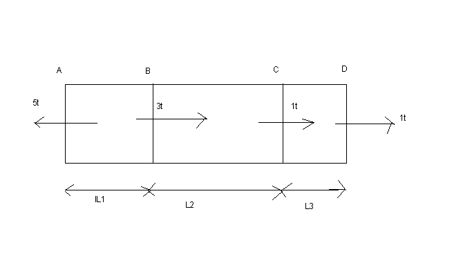

Find the total elongation of the bar, if the bar is subjected to axial forces as shown in the figure. The cross-sectional areas is A and modulus of elasticity is E.
##Y = \frac{F/A}{\Delta L/L}##
Newton's Third Law
243621

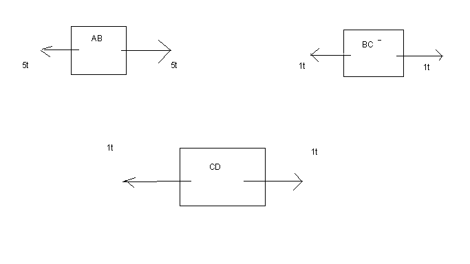

1. Drawing Free Body Diagrams for all components we get :
243622
2. Following this we can find total elongation using ##\Delta L = \frac {1}{AY}(F_1*L_1 + F_2 *L_2+ F_3 *L_3) ##
My questions :
a) I am assuming that the internal forces (3t) are neglected in the FBD because of Newton's third law whereby the force and the opposing force would cancel one another.(?)
b) But if this is the case then why is the 1t force considered on BC?
c) The FBD shows that for a stretching force of 5t an equal and opposite restoring force of 5t occurs (is this correct)?

Your BC FBD is wrong. The 3t and 1t shown as internal must be, in fact, externally applied at the respective joints.
243623
Also, does the fact that the parts are not rigid have any effect on the FBD?
Since the body is accelerating to the left, the tension at C is greater than 1t.
No, no. Only the BC diagram was wrong. All shown forces are externally applied, but there are also internal forces between the blocks. The whole is in equilibrium, so each block is in equilibrium.

To get the tension in the region between B and C, put a fictitious break between B and C, and see what force you need to apply to the. portion of the bar to the left of the break (and/or to the right of the break) such that the left portion (and/or the right portion) remains in equilibrium.

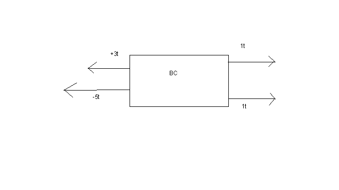

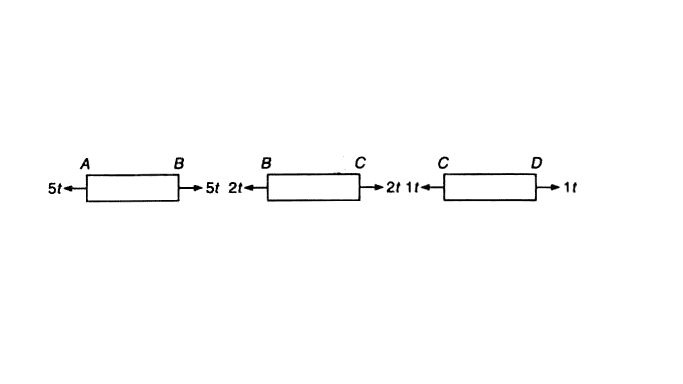

To the left of the break , you would have forces of -5 and + 3, which add up to -2. To the right of the break, you have forces of +1 and +1, which add up to + 2 . So on the part to the left of the break, you would have to apply a force of +2, and, on the part to the right of the break, you would have to apply a force of -2.

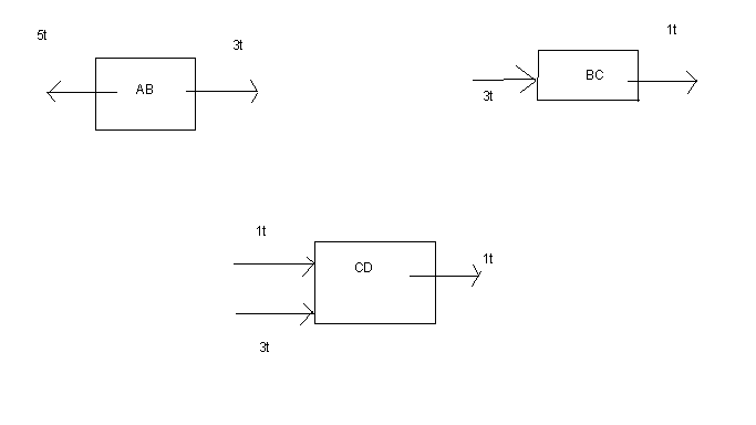

243652
Chestermiller said:
To the left of the break , you would have forces of -5 and + 3, which add up to -2. To the right of the break, you have forced of +1 and +1, which add up to + 2 . Do on the part to the left of the break, you would have to apply a force of +2, and, on the part to the right of the break, you would have to apply a force of -2.
1. So my attempt (the two possibilities in #13) was completely off the mark?
2. Is the diagram I have made now based on your comment correct?
3. If so, why is 3t towards the left (isn't the applied force to the right?) (which would mean a force of 2t to the left and a force of 2t to the right which results in equilibrium)
4. So all the external forces that act on ABCD also act on BC?
5. Since the FBD's show that each block is acted upon by two forces, would each of the six have an effect on elongation? Why not?
Thank you for bearing with this!

The diagrams in post #10 were correct, but perhaps those were not yours?
@Chestermiller was using signs to indicate directions under the convention that right is positive. So in the diagram you should either draw all arrows to the right, but show the values as signed, or draw the forces with negative values to the left and show the values in the diagram unsigned.
E.g. at B, either:
-5t and +3t, both to the right,
Or
5t to the left and 3t to the right.
Yes, I was trying to see if I could understand it by going in the reverse...
I understand the convention now, so 3t would be pointing right and 5t would be pointing left, as you said, 1t's are correct...
Right.
