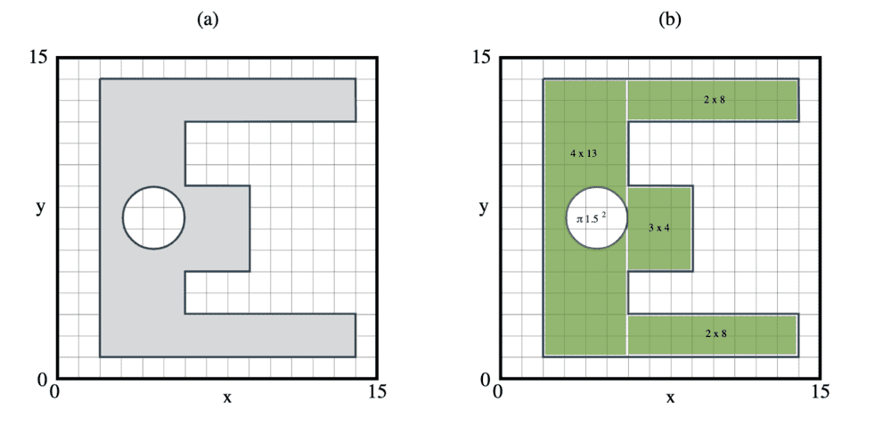

Find the center of mass for the following object.
For object positions along the x axis:
$\mathrm{COM}_{x}=\frac{m_{1} \cdot x_{1}+m_{2} \cdot x_{2}+m_{3} \cdot x_{3}+\ldots}{m_{1}+m_{2}+m_{3}+\ldots}$
And similarly for the y axis:
$\mathrm{COM}_{y}=\frac{m_{1} \cdot y_{1}+m_{2} \cdot y_{2}+m_{3} \cdot y_{3}+\ldots}{m_{1}+m_{2}+m_{3}+\ldots}$
I realize that this is to be solved by breaking up the object into simple objects and using their known center of mass to find the center of mass of the entire object.
1. In the solution the circular gap is also considered in the calculations with a negative center of mass, why is this done?
2. Here the entire object is in the first quadrant of the chosen frame of reference and hence the position vectors are positive. Would the position vectors be negative in the formula if the chosen frame of reference were to be in the middle of the object?
Thank you!

1. You can think of the hole as being created by adding a disc of negative mass to what had been a complete rectangle.
2. The formula doesn't change, but some coordinate values will go negative.

1. Yes but why not simply ignore it?
2. So if ##x_1## is in the second quadrant then ##-x_1## is to be used in the formula?
How ignore it? You have a rectangular plate with a circular hole. If you ignore that there is a hole then you will find the mass centre of the rectangle, which is not what you want. What method are you suggesting?
JC2000 said:
2. So if x1 is in the second quadrant then −x1 is to be used in the formula?
Again, I am not sure what you are saying.
Consider the centre, P1, of the lower 2x8 rectangle. Its coordinates in the given frame are (10, 2). In the formula for the y coordinate of the system, it may appear as ##+y_1m_1##. Plugging in the value you get ##+2m_1##.
Now switch to taking the origin as the point with coordinates (7,7) in the diagram. Now the coordinates of P1 are (3,-5). The formula is unchanged; it still says ##+y_1m_1##. But now ##y_1=-5##, so we get ##-5m_1##.

If ##\mu(\vec{r})## is the area density at position ##\vec{r}##, then the position of the centre of mass, ##\vec{R}##, is calculated via$$\vec{R} = \frac{1}{M}\int_S \mu(\vec{r}) \vec{r} dA$$However you can express the area density function as a sum of any number of arbitrary density functions, say ##\mu(\vec{r}) = \mu_1(\vec{r}) + \mu_2(\vec{r})##, such that at any position their sum equals the actual area density. You get$$\vec{R} = \frac{1}{M}\int_S \mu_1(\vec{r}) \vec{r}dA + \frac{1}{M} \int_S \mu_2(\vec{r})\vec{r}dA$$If you have an object with a hole, like @haruspex said in #2, you can superpose the function with a positive area density of a complete object, ##\mu_1(\vec{r})##, with a function with an exactly negated area density at the position of the hole, ##\mu_2(\vec{r})##.
This is actually a very important technique. In electrostatics, for instance, you can use the same idea to compute things like the electric field inside charge distributions with little bits removed. Even within centres of mass, you might have something like an object made of mostly one material, say wood, but with a small pocket of metal embedded somewhere inside it. The easiest way is often to define two density functions ##\rho_{\text{wood}}(\vec{r})## and ##\rho_{\text{diff}}(\vec{r}) = \rho_{\text{metal}}(\vec{r}) - \rho_{\text{wood}}(\vec{r})##. You can integrate the first over the entirety of the object and the second over the entirety of the piece embedded inside it, and add them together!

OOF! Just realized what I was stating! Absolutely bungled it! I understand now!
Yes I get it now. I was referring to this case. Thanks for the painstaking example!
Thanks for the rigorous explanation!
I had a brain fade and missed the fact that the gap was within the rectangle! Nonetheless, I think I understand the technique much better thanks to your explanation.
