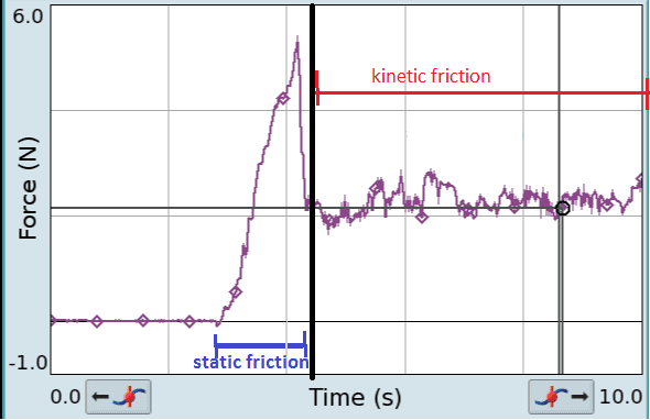

When an object is in contact with another object along an interface, both objects exert an equal and opposite contact force on each other. The contact force has components perpendicular and parallel to the interface; these are called the normal force and friction force.
If the relative velocity at the interface is non-zero, then the friction force is described by the equation ##F = \mu_k N##, where ##\mu_k## is the coefficient of kinetic friction. We say the friction is kinetic. If there is no relative velocity at the interface, then the friction force is described by the equation ##F \leq \mu N##, where ##\mu## is the coefficient of static friction (notice the ##\leq## sign; it's important!). We say the friction is static.
They are not different forces; in both cases, they are the friction force (of which there is only one!). It's just that the equation describing the friction force depends on what's going on at the interface. Have a look at this figure, showing the friction force acting on a block when it is stationary vs when it is moving:
