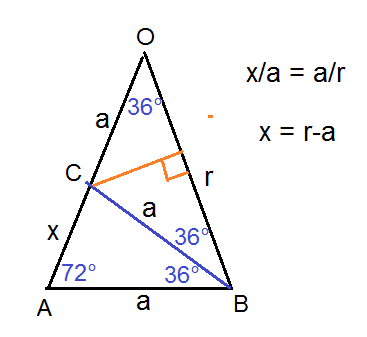

The equation you wrote above isn't an identity, but it is true for an angle of 36° (or ##\frac \pi 5##).
Written a regular decadon into a circle of radius r, it is easy to prove that the side of the decagon is ##a = \frac{1}{2}\left(-1+\sqrt{5}\right)##
Consider the isoceles triangle ABO. The angle at the vertex is 36° and the angles at the base are of 72°. Halve one of the 72°angle, draw the ray, it crosses the side AO at point C. ABO triangle is similar to ABC triangle, so ##\frac {r-a}{a}=\frac{a}{r}##, which results in ##a = \frac{1}{2}\left(-1+\sqrt{5}\right)##
##\cos 36°= \frac{r}{2a} =\frac {1+\sqrt 5 }{4}##
