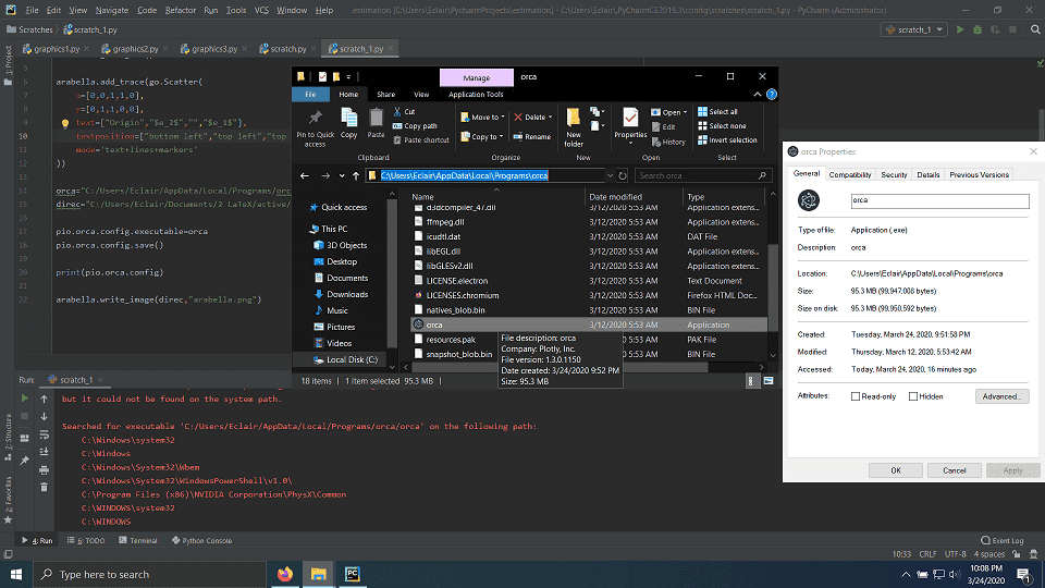

I finally managed to find the orca.exe file; it turns out I had had it installed for almost two weeks, but did not know where it was. In any case, though, I've tried to link to the executable directly by making the correction to the code I posted in the opening post.
Code:
from plotly import graph_objects as go
import plotly.io as pio
arabella=go.Figure()
arabella.add_trace(go.Scatter(
    x=[0,0,1,1,0],
    y=[0,1,1,0,0],
    text=["Origin","$e_2$","","$e_1$"],
    textposition=["bottom left","top left","top center","bottom right"],
    mode='text+lines+markers'
orca="C:/Users/Eclair/AppData/Local/Programs/orca/orca"
direc="C:/Users/Eclair/Documents/2 LaTeX/active/"
pio.orca.config.executable=orca
pio.orca.config.save()
print(pio.orca.config)
arabella.write_image(direc,"arabella.png")
It still returns the same error message. I do not know why that is.

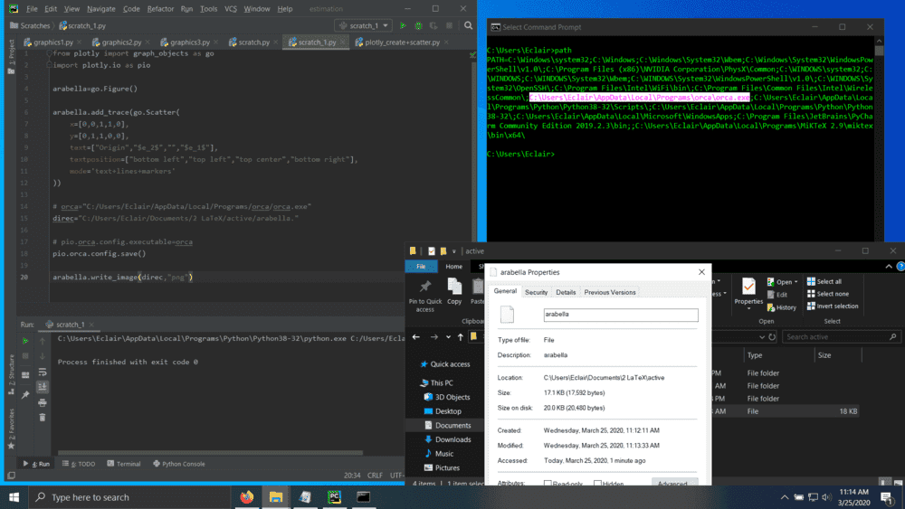

try placing "C:/Users/Eclair/AppData/Local/Programs/orca" in your windows command environment path parameter
and change the line:
Python:
pio.orca.config.executable="orca"
or
Python:
pio.orca.config.executable="orca.exe"
I do not understand. Are you referring to the parameter named in line 14? I did try to fix the problem by appending ".exe" to the end of the string in this parameter, but I am not sure if I did it correctly.

Windows has a path parameter.
When you're in a command session and type path you get to see what its value is. Windows uses it to search for commands that you might type in.
The website I sent earlier mentions the same thing. It says python will use the path to locate the orca command so you need to add the orca command directory to the path.
To set it on Windows:
https://www.computerhope.com/issues/ch000549.htm

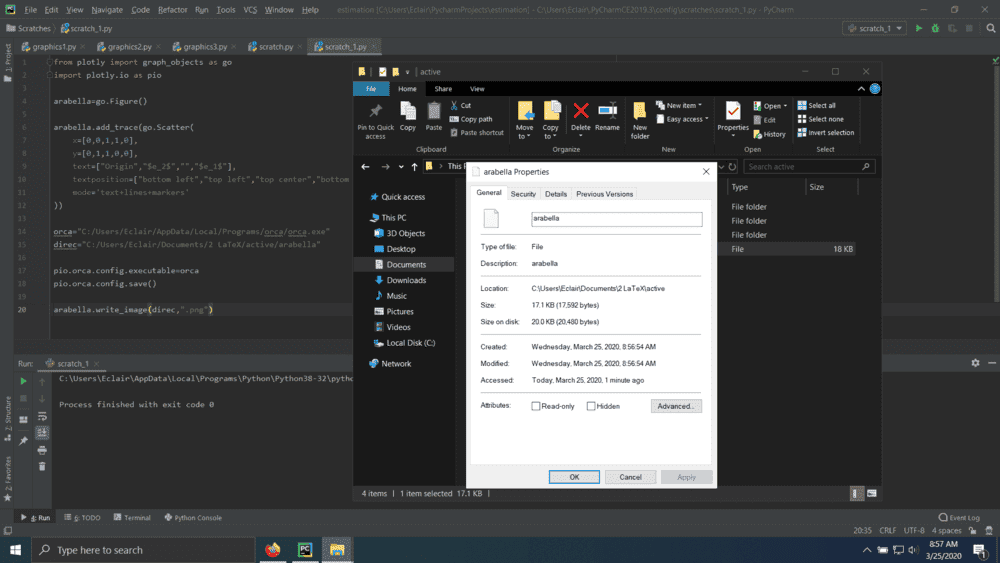

I am not sure if I have done this correctly. Is it normal for plotly to export images as plain files with no extensions?
so it didn't return the file arrabella.png like you specified?
It returns a plain file with no extension. I am not sure if this is intended or not. I can still open it using Paint and it will appear as if it were an image file, though. I was hoping to use the exported images in a LaTeX document, but I can likely find a way to use it as is.
Eclair_de_XII said:
Python:
direc="C:/Users/Eclair/Documents/2 LaTeX/active/arabella"
arabella.write_image(direc,".png")
It exports a plain file, and not a png file, as intended.
It exports a file named C:/Users/Eclair/Documents/2 LaTeX/active/arabella because the argument to write_image is the filename to write, not a directory. So try:
Python:
file_path="C:/Users/Eclair/Documents/2 LaTeX/active/arabella/my-file-name.png"
arabella.write_image(file_path)
