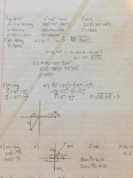

A block of mass 2kg is accelerated by the two forces F1 = 8i + 3j and F2 = -5i - 7j, (a) What is the net force on the block in unit vector notation, and what is its magnitude and direction? (b) What is the magnitude and direction of the acceleration?
I'm not sure of the equation for the direction.
I was able to dot the two vectors to get the Force, but I am stuck from here.
By convention, i,j,k are the unit vectors (of length 1) in the positive x,y and z axis respectively. By using i,j,k you have already taken into account for direction.

You already have the net force in vector notation, am i right? Noting that i and j are unit vectors in the x and y direction, resolve your net force vector into the x and y direction. Then you should be able to see what you need to do to get the direction.
Hint: you need trigonometry

Can you show your work so far? Note that forces sum to yield a net force.
Yeah sure. So far I dotted the two vectors and I got Fnet = 3i - 4j, then F=5 for the magnitude. I then plotted the vectors on a graph and not sure what to do from here.
I don't know what you did here, but the dot product of two vectors is a scalar, not another vector.
https://www.mathsisfun.com/algebra/vectors-dot-product.html
The resultant of two vectors F1 and F2 is found by vector addition, or Fres = F1 + F2
In other words, you add the i and j components of each vector together to produce the resultant vector.
Plot your net force similarly. Do you understand how and why the magnitude of 3i - 4j is 5?
Note that what you did was not a dot product, it's a sum. You would write (8i + 3j)+(-5i - 7j) = 3i - 4j, not (8i + 3j)⋅(-5i - 7j) = 3i - 4j.
To find the angle, make a drawing of 3i - 4j.
Thank you, I got it. I plotted it and then took the inverse tan to get the angle.
