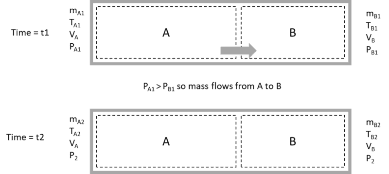

TL;DR Summary: Struggling to structure the problem and derive an analytical solution for gas expanding into other gas in a rigid tank. Preferred formulation is fixed control volumes. This is not a homework problem.
The problem:
Two control volumes (A and B) are in a rigid tank filled with air. The initial state of each control volume is completely defined. There is a pressure differential between the control volumes so mass flows from A to B. Mass flows such that the pressure in each control volume is equal at time 2. There is no energy transfer or work to or from the tank; frictional losses are ignored. Mass and energy are conserved. There is no heat transfer between air masses except for mass transfer across the control volume boundary. Assume immediate and perfect mixing as mass moves into control volume B. I need to be able to calculate the final state of the air masses in the control volumes (P, m, T). This is straightforward to do numerically, I would like an analytical solution.
Some Background:

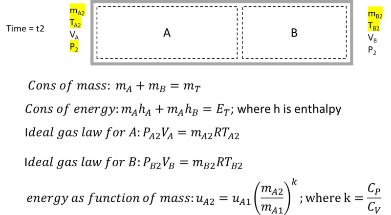

Systems of Equations:
Using fixed-size control volumes, there are 5 unknowns at the final state (mA, mB, TA, TB, P2). I find 4 equations: conservation of mass, conservation of enthalpy ( that is; hA1mA1 + hB1mB1 = hA2mA2 + hB2mB2. Is this a valid equation?), and ideal gas law for both volumes at the end state. This would not be enough to solve for 5 unknowns. Is there another obvious one? I considered relationships for polytropic processes, but was not confident they apply for fixed control volumes. I did derive a 5th equation that relates internal energy to mass flow for control volume A (shown below) but I'm hesitant about it. Solving this non linear system of equations is beyond me. Perhaps you can point me in the right direction?
Control volume energy balance, integral with respect to time:
Starting with the general energy balance equation for volume A, I eliminated terms for heat flux, work, and mass flow in. I then differentiated (chain rule) um with respect to t. The m-dot term here makes no physical sense (mass does not just disappear) so is zero. Using the definition of enthalpy, the ideal gas law, the specific heat relationship u = CvT, the definition of k = Cp/Cv, and integrating both sides of this separable differential equation. I arrive at internal energy as a function of mass flow and time. assuming mass flow is constant this can be re-written as internal energy as a function of mass in the control volume. (Note: It is possible to perform this integration as du/dm rather than du/dt. The result is the same.) This is an simple, elegant equation (which I cannot verify externally). However, when using this relationship to assemble a differential equation for control volume B, I get an unwieldy equation I cannot figure out how to integrate.
Combined control mass and control volume:
I can also structure the problem as control masses instead of control volumes. Essentially, mass A pushes into mass B, doing work Imagine a piston between the air masses. Using polytropic relationships for isentropic flow, and the relationship of total volume being constant, I can solve for P2. I can then use this P2 and the control volume relationships to solve for the changes in mass, then find other equations of state. This is fine, but feels messy and kludged.

First, the analytical solution.
Assume that Pa > Pb so mass only flows from Volume A to Volume B.
For Volume A:

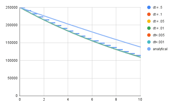

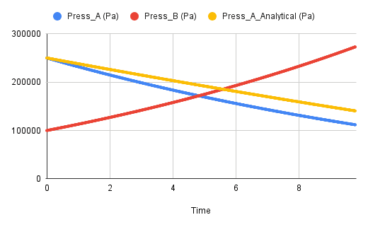

I put together a simulation using Euler's method to model the change in pressure over time (or, over ##\Delta m = \dot m\Delta t##). The simulation can be found in this google spreadsheet. The chart below shows the change in pressure for each volume. (##\dot m## is set to a constant, not as a function of pressure, so mass continues to move from A to B, even after the pressure in volume A is less than the pressure in volume B). It also shows the analytical solution to the pressure in volume A. Much to my disappointment, the analytical solution differs significantly from the numerical solution, suggesting that I have made an error somewhere above.
Is this simply an error of mathematics? Or have I conceptualized this problem incorrectly? I'll continue my work to find out, but any help from the community here would be appreciated.
What you are looking at is numerical inaccuracy. Either use smaller time steps or use a higher order integration scheme than forward Euler.
Chestermiller said:
The first law of thermodynamics tells us that the total internal energy of the combined system is constant.
Total internal energy being ##U_A + U_B## in this case, right?
I re-ran the simulation with a variety of time steps. (The 0.5s stair step series is because I sample the data set at .1 seconds but the simulation only ran at .5 seconds.) The pressure values all quite agree (they essentially overlap!) relative to the analytical solution.
This indicates I've made a mistake somewhere. I'll re-check my math to see if I can find out where.

I found the error in my numerical solution above. I messed up my algebra and accidentally left out a term. Rather than: ##u_2 = \Delta t \dot m\left( h_1-u_1\right) + u_1 ## (for volume A), it should be ##u_2 = \Delta t \frac {\dot m}{m}\left( h_1-u_1\right) + u_1 ##
This causes the numerical solution to agree very well with the analytical solution, even for relatively large time steps.
Interestingly, when solving the analytical solution for Volume B using the conservation of energy equation, the equation is quite messy, especially when setting ##P_{A2} = P_{B2}## and solving for ##m_{A2}## as follows:
$$P_{B2} = \frac {U_TR} {C_VV_B} - \frac {V_A}{V_B}P_{A1}\left(\frac{m_{A2}}{m_{A1}}\right)^k$$
$$m_{A2} = m_{A1}\left(\frac{RU_T}{P_{A1}C_VV_T}\right)^\left(\frac 1 k\right)$$
However, I noticed that the final pressure can be calculated as:
$$P_2=\frac {P_{A1}V_A + P_{B1}V_B} {V_A + V_B}$$
which, in retrospect, can be calculated from the conservation of energy equation ##U_{A1} + U_{B1} = U_{A2} + U_{B2}## by using the simplifying assumption ## u=C_VT ## and the ideal gas law ## \frac {PV} R = mT##.
I'm still looking for a similarly elegant way to calculate final mass or temperature (though, several posts above I shared the analytical solution for pressure in A as a function of mass, which is likely the best method. If anyone knows a simpler way to m or T that avoids the calculus I did above, please let me know.

Here's a hint. If you know P2, then you know ##m_{A2}## because $$P_A=Cm_A^{\gamma}$$
Thank you. Yes, this can be found from the indefinite integral of the equation I listed a few posts ago (where I took the definite integral):
