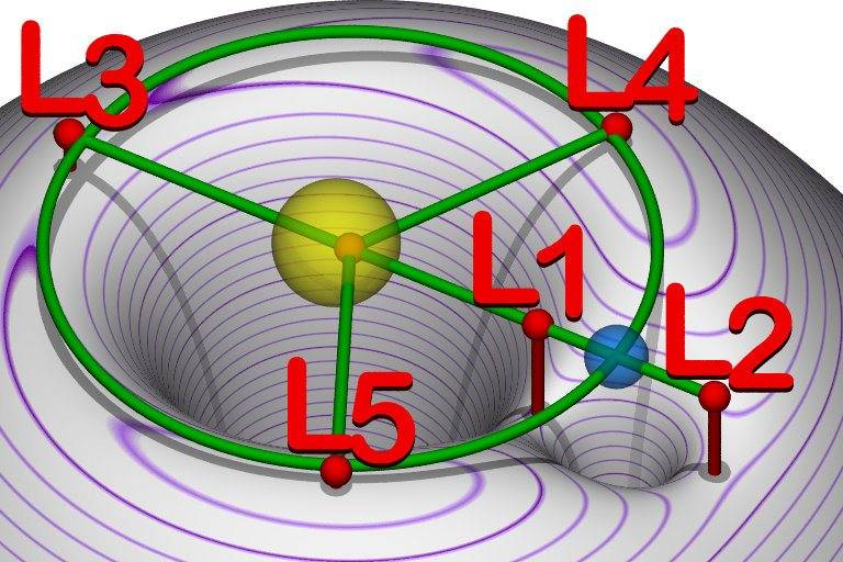

1) I'm having trouble understanding the stability of the stable Lagrangian points (L_4 and L_5); Wikipedia explains that if an object in the L_4 or L_5 of a planet is pushed closer towards the common center of gravity of the Sun and the planet, the increased speed that comes from a reduced distance to the center of gravity (due to conserved angular momentum) compensates for this (and the other way around (i.e. if it's pushed farther from the center of gravity)). I don't understand it intuitively nor can I explain it physically. Anyone care to have a go explaining it? Google seems to yield nothing.

A.T. said:
Are they stable?
They are, no? Hence the massive number of Trojans in Jupiter's orbit.
Contadoren11 said:
They are, no?
They are maxima of the potential. Any deviation from their exact position will make an object move away from them.
On the contrary. Any deviation from the exact position of L4 or L5 will tend to cause the object to drift back toward them.
L4 and L5 are minimas if I remember correctly.
jbriggs444 said:
Coriolis acceleration apparently provides the required impetus toward the Lagrange points
It's not necessarily towards the Lagrange points, but perpendicular to velocity in the rotating frame. So I can see that when they drift away from the Lagrange points due to the potential gradient, Coriolis acceleration can make them go in a circles, preventing or delaying the escape from the potential plateau around the maximum.
