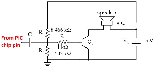

Hi there! I've been tinkering with some homemade speakers, and wanted to make a simple amplifier circuit to step up the some 3 volts that comes out of an aux jack to 9 or 10 volts. I decided that the common-emitter model looked the easiest to understand. I was mistaken. This is the simplest diagram I found while poking around the internet:
Assuming that I change the component values, it becomes immediately apparent that the input & output voltages are being crossed over on the same line. How does this work? What does the ground symbol mean at the bottom? I appreciate any advice the community can give - thanks :)

The schematic looks to be a reasonable starting point for a prototype. What do you mean by voltages "crossing over"?
Could you be alluding to the fact that a common emitter amplifier is a Voltage Inverter? As the input volts go more positive, the collector current increases so the collector volts (set by the voltage drop across the LS) go less positive. As the collector load is somewhat inductive, the voltage swing can be more than if it were just resistive.
Likes berkeman
There are several issues with your circuit, but I will just state the main one: Your loudspeaker is biased DC-wise by the collector current. This means that the speaker diaphragm will be constantly displaced from its normal position and since the collector current can never change direction, less than half of the effective speaker volume will be available.That is why loudspeakers are always AC-connected, either via a transformer or a capacitor. See below for an example.

Even this circuit has a problem. The output transistor can pull the output low very fast end very effective, but it cannot push the output high. The only thing that can make the output go high is the 1.2k resistor. Therefore you will have a very asymmetrical drive of the loudspeaker. The solution is to use two output transistors, one to pull the output low, and another to pull it high.
With a collector load of only 8Ω, there's a lot of "pull up".
Well, the 8Ω is a fiction. The impedance of a loudspeaker is very variable:
The real trouble lies in the DC biasing which forces the loudspeaker cone away from its natural "zero" position.

According to this the input and the output is not crossed over, but: the input has a resistor to the power rail (this is required to provide adequate bias for the resistor) and the output is using the power rail as a source of power.

This quotation from the OP is confusing for a start. The 'Input' signal is AC coupled and could have any mean voltage and its peak to peak swing is not mentioned. The volts on the input end of the 1k resistor could easily be more positive than the Vce of the transistor when it's saturated. We have been discussing this in more detail than the original diagram needs. Other than it definitely being an inverting amp, there's nothing more to be said about signal values.
An emitter feedback resistor could improve matters greatly as it would define the circuit mainly in terms of the component values rather than the (unknown) transistor characteristics.
