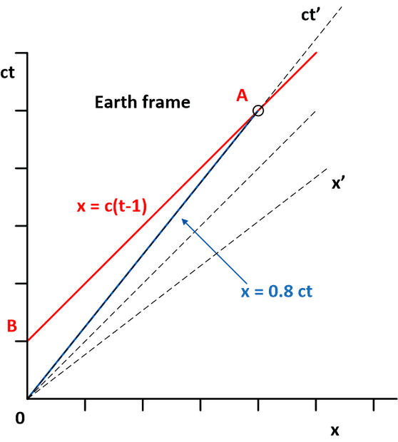

I'm having trouble with this specific problem/though experiment: Suppose you have a satellite travelling at v=0.8c and at t=0 it aligns with the earth. At t=1 year in the earth's frame of reference, a signal from mission control on earth is sent to the satellite. How long does it take for the signal to travel from earth to the satellite, in the earth's frame and in the satellite's frame?

Your diagrams are not very useful. You want to draw 2D Minkovski diagrams:
For the diagram in the earth's frame you have one line for the satellite position: ##x = 0.8 ct## and one for the light signal: ##x = c(t-1)##. Where do they intersect ?
Very good. At ## x= 4, \ ct = 5## light years ! (*)
In agreement with your PDF page 1.
Then, on page 2: the time dilation formula yields ##\Delta t' = 2.4## years. (never forget the units)
Here, however, your confusion has already started: Four years have passed in the earth's frame. Equivalent to 2.4 years in the satellite's frame-- but these intervals DO NOT START OR END AT THE SAME TIME in both frames!
The four years is the right answer to the first part of the problem. For the second part some work needs to be done.

Earth and satellite do NOT, however have the same times nor x-coordinates for the event 'departure of the signal from earth', as becomes clear from the Minkovski diagrams, and also when one does the calculations :
(*) to check things, we are going to use the Lorentz transform and see what the satellite frame coordinates for the events A and B are.
Notation: ##x, \ ct## unprimed is in earth frame,
##x', \ ct'## primed is in satellite frame. Units are light years.
For the earth frame we have ##\beta = v/c = 0.8,\ \gamma = 1/\sqrt{1-\beta^2} = 1/0.6##
For the satellite frame we have ##\beta' = v'/c = -0.8## !
For A, the arrival of the signal at the satellite: $$\begin{align*}
x'&= \gamma(x - \beta ct) &= 0 & \phantom{x} \\
ct'&= \gamma(ct - \beta x) &= 3 &\phantom{x} \\ \end{align*}
$$For B, the departure of the signal from earth: $$\begin{align*}
x'&= \gamma(x - \beta ct) &= -0.8/0.6 &=-4/3 \\
ct'&= \gamma(ct - \beta x) &= \phantom{-}1/0.6 &=\phantom{-}5/3 \\ \end{align*}$$
It is instructive to do the inverse transform too !
At last, we can work out the second part of the answer to our problem: arrival at ##ct'= 3 ## ly, departure at ##ct'= 5/3 ## ly, so the light has traveled for 4/3 year on the satellite's clock.

And the diagrams:
Hi, thank you so much for your detailed answer. Please excuse me for not replying for so long. Life has been very very chaotic.
Even the 0.48 ly is right, but it is not the distance the light has to travel in the satellite frame !!!!
Could you please explain what this o.48 ly actually is a measure of?
By this, do you mean that 4 years passed is indeed 2.4 years in the satellite's frame, but since the event of the departure of light does not happen simultaneously in both frames, 2.4 is not necessarily the number of years needed for light to travel from the earth to the satellite in the satellite's frame?
Aha! So my main mistake is assuming that light departs from the earth in the earth's frame at the same moment as in the satellite's frame?
