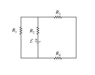

The specific circuit I was having trouble with is:
241054
I don't think I need to include the specific values, but the battery voltage and the resistance values for each resistor are given.
I tried breaking the circuit up into loops, but that doesn't seem to work very well. The problem asks what the currents going through each resistor are. I don't know how to find those values or the voltage drops.
I guess I can find the voltage drops if I can find the currents - because they would just be the currents times the given resistances, right? R34 is in parallel with R2 and R234 is in parallel with R1. So V34 = V2 and V234 = V1? Is V134 = V2?
Is I3 = I4 = I(eq.) for the entire circuit?
If somebody could help me understand how to apply E = IR along with the rules for parallel and series circuits that would help immensely.
There are serveral methods to solve this problem. Perhaps it is better to know which method your professor expects you to use. Is it mentioned in the problem statement?
Also, it will be easier to work it out with the given component values instead of using variable names.
No, R34 (the series equivalent of R3 and R4 ) is not parallel with (Edit:)R2. Two resistors are connected in parallel if they have two pairs of terminals in common, but one terminal of R2 is connected to the positive terminal of the source.
But R1 is parallel with R34.
241064
The red dot is common for all the tree resistors, but the blue one is common for R1 and R34 only.
No
ehild, you said that R34 is not in parallel with R1 but R1 is in parallel with R34? Is that what you meant to say? My understanding was that if two resistors are in parallel, then they are in parallel to each other. Did you mean to say R2 is in parallel with R34?
Sorry, I meant R34 is not parallel with R2.
Likes gibberingmouther
I had trouble for awhile, but I think I get it now thanks to an electronics site I found and the hints on Pearson. I just need to do some practice problems so I'm less likely to make mistakes when I take the final exam, because solving these circuits sometimes involves a lot of steps and algebra.
