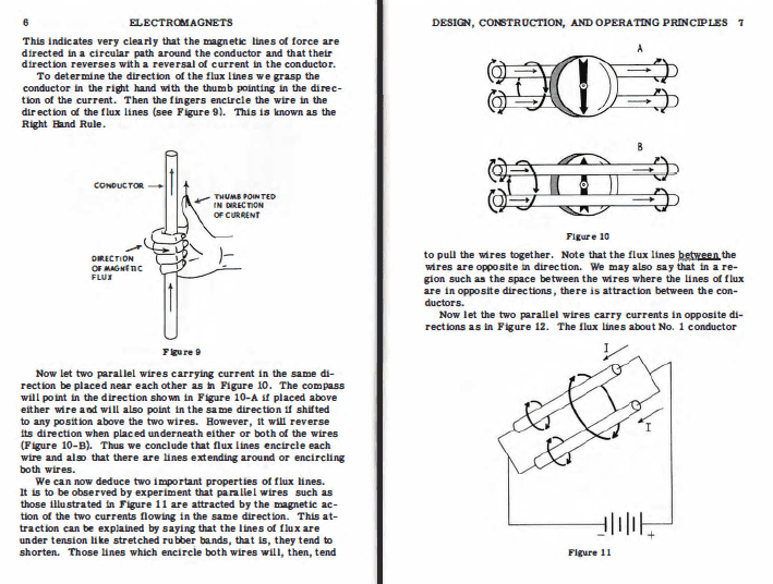

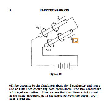

When reading about directions of magnetic flux in relation to current flow on pages 6 to 8 of http://www.free-energy-info.tuks.nl/Non-Ferrous-Magnet.pdf , I found that in figure 11 the current is traveling from + to - terminals, while in figure 12, the current flows from - to + terminals. I am still learning about the basics of circuitry and magnetism, and I want to understand why and how a current can flow in both directions.
None that I know of. If there are some I would like to be enlightened.
After reading this article "http://www.blueraja.com/blog/179/do...tive-to-negative-or-from-negative-to-positive" I found that from a Physics standpoint a current would travel from - to + in reference to electron flow, but in electronics it doesn't matter. Why doesn't it matter? Can a current move both ways or only one?

Looks like you caught an error in the text! The two arrows in figure 12 should be reversed so that current will be flowing from + to - in the wires. The directions of the magnetic fields in fig 12 should also be reversed.
Oh, ok. Does this mean that currents ,in reference to an electrical perspective (as opposed to a Physics perspective), always travel from + to - in DC and AC currents, or are there exceptions?
As long as you take current to be in the direction that positive charge would flow, then current will always flow in a conductor from higher potential to lower potential. The + and - refer to regions of higher and lower potential respectively. This is true in both DC and AC circuits. In AC, the potentials of the two ends of a conductor are alternating in regard to which end is at the higher potential.
The usual convention in physics today is to take current to be in the direction that positive charge would flow, therefore opposite to the direction of electron flow. I believe that this is also the usual convention being used in electronics. However,some older texts take the direction of electron flow to define current direction. So, you have to be careful when switching between different books.
