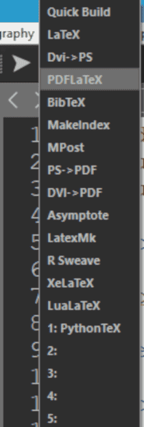

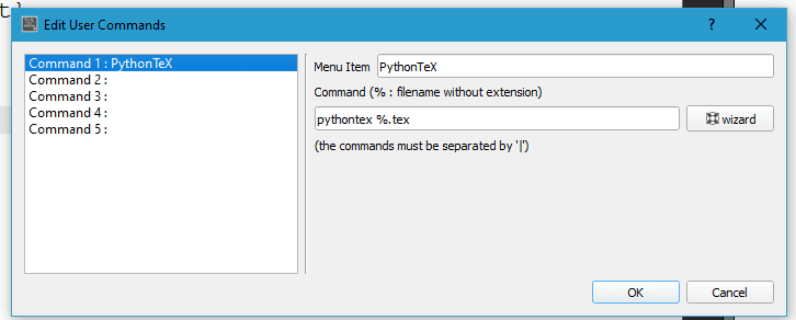

I use TeXMaker. The user manual is here. Section 3 describes the basic process of compiling a document.
On the toolbar is a drop-down list of standard TeX-related tools, which can be run on the current document by pressing the button to the left.
PythonTeX is not one of these, but as you see I have set is up as the first user defined command. To do this, go to User > User Commands > Edit User Commands and complete the dialog as follows (setting up user commands is only mentioned in passing in the user manual):
To compile the document correctly, you must do the following:
- Run LaTeX or PDFLaTeX
- Run PythonTex
- Run PDFLaTeX again.
