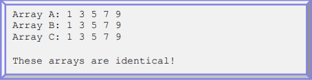

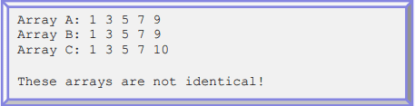

Write a function that finds if three arrays of integers are identical. The arrays are identical when they have the same values at the same indices. Below are two samples outputs.
N/A
I decided to compare the arrays using a for-loop. I feel like that's a messy way to go about it but I'm not really sure how else I can make it work. Here's my code.

It prints "These arrays are identical!" regardless of whether or not that is true. I'm not understanding why it won't work.

The statements x==1 and x==2 should be x=1 and x=2.
Also:
the "else if" part is not needed. It can be a simple "else".
