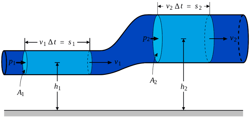

Could you please draw a figure which explains what you mean with those artificial extensions.
I know this could be quite much to ask for, I am very poor myself at drawing figures and upload them to the web, but I would very much appreciate if you could do this.
It's on the wiki page where the proof is:
In the middle we have the actual system with a changing cross section.
And to the left and right we have artificial extensions with constant cross section intended to say something meaningful about how much energy we add/remove.
Likes Greg Bernhardt
Thanks, but in each of the extensions, both area and pressure are constant. On the other hand, comparing the extensions, both area and pressure are unequal.

I have trouble with both of them:
https://en.wikipedia.org/wiki/Bernoulli's_principle#Derivations_of_the_Bernoulli_equation
In the first derivation, using Newton's second law, it is claimed that the effective force on a parcel of the fluid is ##-Adp##, but in my opinion, it should be ##-Adp-pdA##. I see no the reason why the cross-sectional area should vary less than the pressure.
The element of the fluid is conveniently chosen so its two lids are both perpendicular to velocity and have the same area. Only then total force on the element in the direction of flow is ##Adp##.
But in such a situation, the pressure is also the same.
