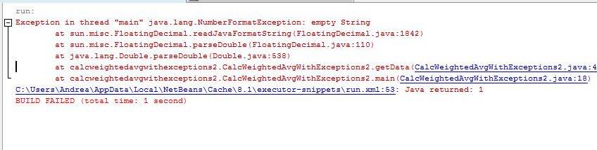

smilesofmiles said:
Hello mathhelpboards community! I can't figure out how to get my code to execute while using buffered reader and try with resources. :-( I created a data.txt file correctly and it contains the numbers "0.5 3 10 70 90 80 20" without quotes. I added a catch IO Exception utilizing the printStackTrace function believing this would allow my program to run. I tried redoing the way I added the elements into my arrays thinking that I wasn't using buffered reader correctly. Frustration led me to google and youtube but I wasn't able to find buffered reader being used to add elements to an array. This was also my first time implementing FileWriter. I believe that portion is done correctly?
Any help, hints or points to the right direction will be greatly appreciated!
Code:

Hey smilesofmiles! ;)
Your code seems to run fine.
What is the problem?
Hello I like Serena! When I run my program it fails. I keep encountering this message. The last program I made with exceptions didn't have any error messages. Thank you for answering me! :-) View attachment 5797
That would happen if the data.txt file is not there, or it's in the wrong location, or if it's empty.
You may want to remove the [m]if(file.exists())[/m], so that a missing file gets reported.
Note that the exception is only later in the code when it tries to access the 2nd number that is simply not there.
