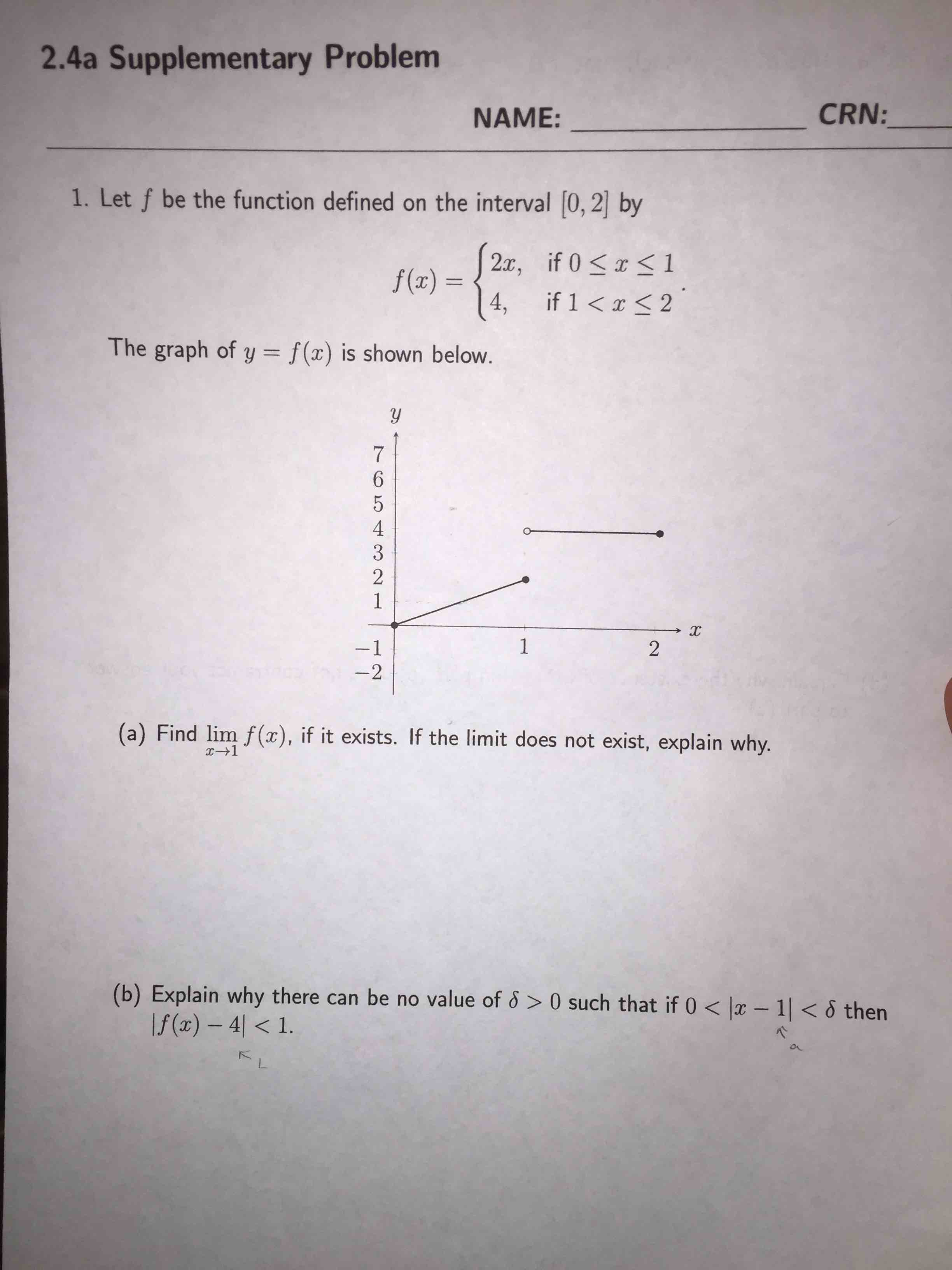

I understand and can do part (a) of the problem but when it gets to part (b) I'm lost, how do I find/explain why there is no value of delta > 0 that satisfies the the problem.
Because the set of $x$ satisfying $0<|x-1|<\delta$ (the deleted neighborhood of 1) always has elements for which $|f(x)-4|\ge2$: namely, those $x$ that lie between 0 and 1. Whichever neighborhood of 1 you choose, it will always have elements smaller than 1, and for those elements the value of $f$ is $\le 2$, so its distance to 4 is greater than 1.
Part (b) is not a sentence to prove because \(\displaystyle x\) is free.
(b) Explain why there can be no value of \(\displaystyle \delta>0\) such that for all \(\displaystyle x\in [0,\ 2]\) if \(\displaystyle 0<|x-1|<\delta\), then \(\displaystyle |f(x)-4|<1\).
Now this is a sentence to prove.
