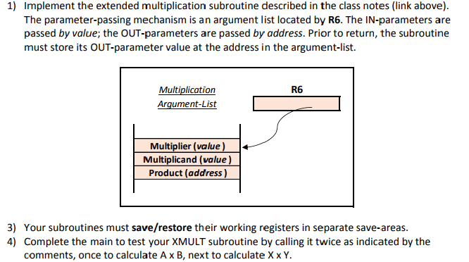

So basically, I have to implement the algorithm given in the relevant equations section.
First and foremost, my code. Some bits that weren't directly relevant to the problem I'm having were removed for readability's sake. The RightShift subroutine implements a logical shift right. Print subroutine just prints the contents of R0 onto the console in binary form.

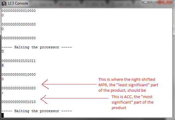

The part that's giving me problems is in the MUltiplication LOOP (MULOOP in the code). A little perspective: I'm trying to test my code on the first bit multiplication given in the code, namely, I'm calculating
AB = A x B
where A = x0010 = b0000 0000 0001 0000
and B = x00AB = b0000 0000 1010 1011
To illustrate my problem, here's what happens when I execute the program:
Ignore the characters - those are there because the print function I used was borrowed from some other code I wrote that was supposed to print the char representations of bits.
Notice the first two bit values, 0000 0000 1010 1011 and 0000 0000 0001 0000. These correspond to the values A and B, which in decimal are 171 and 16, respectively.
The last two bit values, 0000 0000 0000 0000 and 0000 0000 0000 0000 1010, correspond to the right shifted MPR and ACC values that are supposed to represent the product of the two numbers.
Now, according to some bit multiplication calculators I've consulted, the product of x0010 and x00AB should be xAB0 = b1010 1011 0000
So basically, once the loop has fully iterated and the right-shifted ACC and MPR values are stored into their respective memory addresses, ACC contains a value that could possibly be part of the right answer (x000A), while MPR is totally empty (x0000).
For the answer to be correct as it is, MPR should contain xB000 = b1011 0000 0000 000, since that way ACC:MPR represents xAB0.
In other words, the problem I'm having is that the implementation isn't fully working. I say "isn't fully working" because I've been sitting at my PC for the past few hours using the Step Into function on my LC-3 simulator to go through the code step by step, and I can say for sure most everything in my code is working as intended.
Stepping through MULOOP one step at a time, however, reveals something strange: while the logical shift right works properly for both ACC and MPR (the values in each are divided by two, with truncation, each time), MPR gets divided all the way down to zero before the loop exits.
In fact, ACC used to get zeroed out too at first, when I had my counter set to 16 - this was because the multiplication loop is supposed to iterate N times, where N is the number of bits that make up the numbers you're multiplying, and since the LC-3 is 16-bit addressable, I thought I'd set the counter to 16 bits.
The reason I changed it to 8 is that technically x0010 and x00AB are 8 bit numbers (normally you'd represent them as x10 and xAB, respectively), so I thought maybe 16 iterations of the "multiplication loop" was too much for two 8 bit numbers, and was causing the right shifts within the loop to zero them out (due to being executed too many times).
So that's where I'm at right now. I need to either get ACC to be x00AB instead of x000A (what it is now) or get MPR to be xB000 so that ACC:MPR reads x000A B000, which would be correct for the purposes of the algorithm.
But I don't know what to do. I don't even know what's going wrong. The error must be semantic in nature, because as far as I've seen during program execution, the syntax is correct.
Any help would be appreciated.

You are right shifting you low order results into the bit bucket.
Here's how you are using you registers in that loop:
R1: Multiplier (halved on each cycle, ends up zero)
R2: Multiplicand
R3: High order by of product.
R4: Loop counter (8,7,6,... 0)
R5: Bit mask for odd/even bit (1).
At the end, you store R1 and R3. Which is zero and the high-order byte of the product.
You are generating the low-order bits, but never saving them. The get shifted into oblivion when you right-shift R3.
