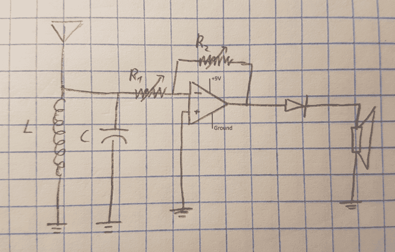

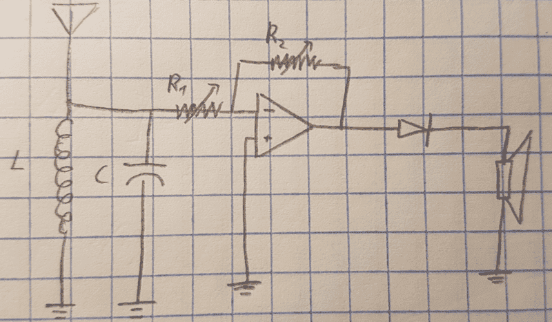

Hello,
I have assembled the following AM radio reciever circuit:
Purpose of the circuit: To receive AM radio signals and provide the output audio of these signals ( demodulated ).
Circuit elements: L ~ 1.5mH , C ~ 300pF , Amplifier IC: LM324N , Diode: 1N4004 ,
The speaker is small and it's resistance is ~ 5 ohm
There are 2 variable resistors, to adjust the amplification.
The antenna is a long wire
The voltage provided to the amplifier is 9V DC from battery ( not drawn )
My expectations from this circuit:
- the antenna would receive a signal
- the bandpass filter would filter the signal so the output signal's ( to the amplifier ) frequency spectrum is centered at ' Fc '
- the filtered signal would get amplified by the amplifier which is connected in negative feedback configuration
- the signal's negative voltage would get truncated by the diode
- the signal would pass through the speaker to the ground and thus I would hear AM radio station broadcast.
Experimental results
- There is no voltage drop on the speaker at all and no current flows through it, thus it is mute.
- Most voltage drops on resistor R2
Notes:
- the central frequency of the bandpass filter is Fc=1/sqrt(LC) ~ 1.49MHz
- the ground in the circuit is the cathode of the 9V battery
My question is:
Is this circuit wrong? , if not, then what do you propose as being the fault to the failure of the system?
If it is wrong, then why?
Thanks in advance for help.

Some quick thoughts...
  • The LM324 is pretty slow to get much gain out of it at 1MHz (AM band)
  • Even though the input and output range of the LM324 includes ground, you will get better gain if you bias up the input (AC couple the signal) and AC couple the connection to the speaker
  • It seems your rectifying diode should be before the opamp, not after. In that case the LM324 would be fast enough to amplify the audio frequency AC envelope signal...
Likes CGandC, davenn and Paul Colby

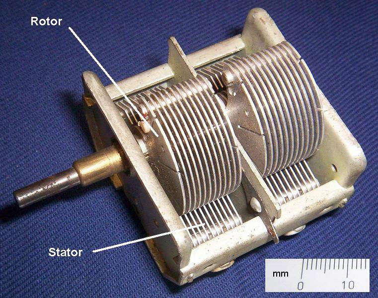

Also, you will get a lot better performance if you make the LC tank circuit variable, so you can tune to the desired AM radio frequency selectively.

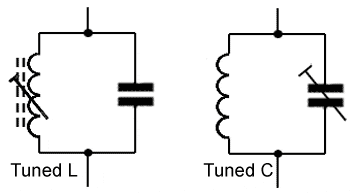

Quiz Question for @CGandC -- Are you familiar with how you would implement each of these methods for a tuned LC circuit in your AM receiver application? :smile:
http://www.learnabout-electronics.org/ac_theory/images/Tuned-cct.gif

Issues I see:
OP's formula for frequency of tank circuit is wrong.
Circuit will require 700mV of RF signal to overcome the diode drop and deliver a signal to the speaker. No way one amp will get us up to that level. The diode needs to be biased to its knee. One way to do this is using an active half wave rectifier (op amp with 2 diodes inside feedback).
5 ohms is a pretty low impedance to try to drive.
I suggest OP download and learn LTSpice, simulate first, then build. It can be a real pain to try to get something like this working by just hacking at it. It's a lot more satisfying getting it to work in simulation then having it work reasonably well once built. Start with a generous 1mV antenna signal (like you are close to a strong AM station and you your L is wound around a big oatmeal box).
Yes, then i'll have to order such elements as to make ' Fc ' variable.

Agreed -- OP, what is missing from this equation? :smile:
You are right, I was calculating the Angular frequency ω not 'Fc' turns out I had to divide my frequency by 2*pi.

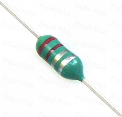

So I chose L=40µH and kept the same capacitor value ( Fc ~ 1.45MHz) , yet , no audio is heard.
just to elaborate, I'm using an inductor that looks like a resistor... but I saw everyone use an exposed copperwire coiled around some material , is it wrong to use such an inductor ( which I use ) when attempting to pick up signals?
That inductor looks pretty lossy. Can you measure its resistance with your DVM?
Also, have you moved the diode and added bias to your opamp circuit yet? If not, I'm not surprised that you are not getting an audio signal yet.

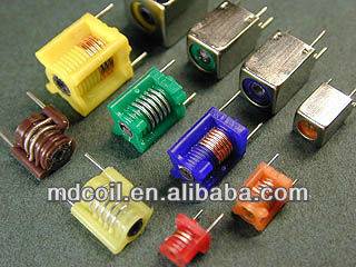

The inductor and capacitor used in such a tuned circuit often look like these:
https://upload.wikimedia.org/wikipedia/commons/6/6c/Variable_Capacitor.jpg
https://sc01.alicdn.com/kf/HTB19xLt...stable-IFT-inductor-coils-slug-tuned-coil.jpg

I would move the diode to the front end for detection, as berkeman suggested, and use the op amp for audio amplification. Also use a germanium diode (such as the 1N34A) instead of silicon.

Where did you get the schematic that you drew? If you just drew it yourself as something you wanted to try, that is fine of course.
You can use Google Images to find circuits for simple AM receivers. Have you tried that yet? :smile:
TurtleMeister said:
Here's a close match to your circuit (if you move the diode to the front):
http://www2.ensc.sfu.ca/~ljilja/ENSC220/Labs/lab_5.html
Nice! And for @CGandC -- note how that opamp uses split supplies, If you only have the single 9V supply, you should still make a center-bias circuit for the opamp. Or else add a second 9V supply (battery?) to give you split supplies to make things easier.

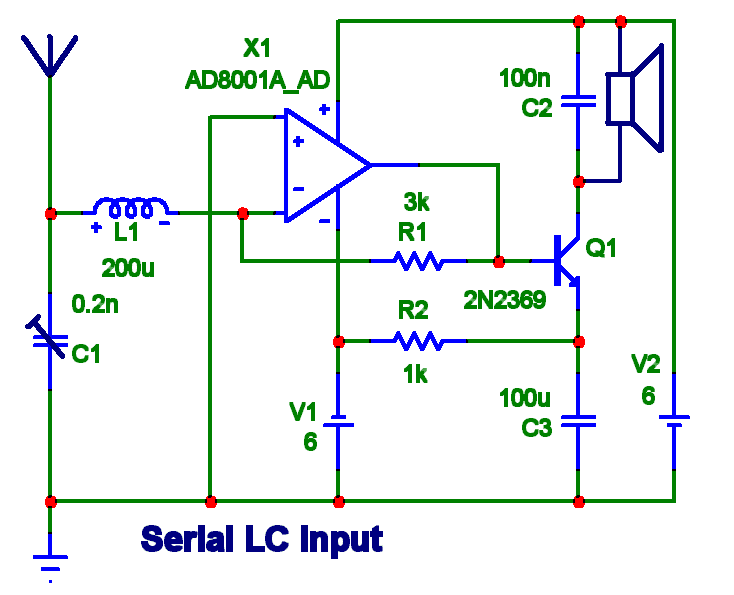

How about trying a serial LC at the input?
It seems interesting because the input resistance of the amplifier can easily be made negative by adding some part of the opamp output voltage to its " + " input, making the receiver regenerative.
Where is the detector in your circuit?
Likes berkeman
why, it's the transistor, just notice the big capacitor to the emitter. The emitter junction works like any diode.
Very subtle if true. :smile:
Can you share a SPICE simulation that shows it? I tried to visualize it when you first posted the circuit, but didn't see it right off the bat...
Also, what's the GBW product of that opamp? (I'm too lazy to look it up, sorry)

Look, you're not a newbie here. Post the plots please. How does the envelope end up at the speaker?

That's an interesting circuit. Is it your design, or where did you get it? This takes me back to my younger days when I would spend many hours experimenting with simple am receiver designs. However, I didn't have IC chips or SPICE. Just a junk box.
It looks to me as if the transistor is biased for linear operation, so that the B-E junction will not rectify as it is forward biased.
The base is at half supply voltage and the emitter is connected to -ve via 1k. This looks like normal common emitter operation for a linear amplifier stage.
Likes berkeman and Averagesupernova
- again, think of the 100 (or better 1000) microF capacitor at the emitter. It makes the emitter potential practically constant during a typical audio wave period. Therefore, the collector current is an exponent of the radio wave, the average is the audio signal. The only disadvantage here is that the detector is not linear at strong signal or strong noise ( - but the thing is, where I live, the MW signals are all very small, so anyway my detector is doomed to be just as quadratic as any simple detector at small signal).
(The other thing is the emitter resistor, it must of course be much more than 1kOhm if the load is an old high-resistance headphone.)
