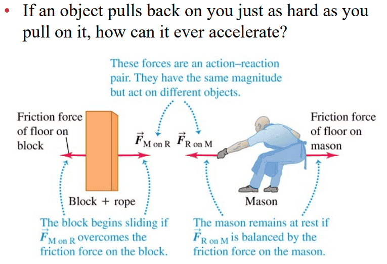

Two persons A & B are pulling the two ends of a rope (As people do in tug war).Person A pulls rope with a force=10N and the person B is pulling another end of the rope with a force =20N. According to Newton's 3rd, rope will also pull person A with force=10N and B with a force=20N. It means tension at one end of the rope is 10N and at the other end tension is 20N(Because of the definition of tension).Is it correct? If yes ,then pulling force on A by the rope will only depend on force exerted by A on rope and will not depend upon the force applied by B on the rope. In that case , if B is pulling the rope with a force=1000N and A is pulling the other end of rope with a force=10N, then the tension at that end(where A is applying force) will be only 10N.It means the force by which rope is pulling A will be only 10N. Is it possible?

The simplest way to think about it is that there is a tension ##T## in the rope. And both people are pulling and being pulled with the same force ##T##. For an idealised, massless rope there can be no unbalanced force. The forces at either end must be the same.
The difference in a tug-of-war comes from the forces exerted on the ground.
Alternatively, analyse a tug-of-war in space.

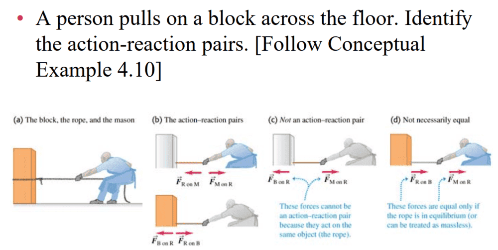

The two ends of the rope cannot be pulled with different forces without the rope itself accelerating. And, if the rope is light, the difference in forces (tension) at each end will be small.
In an ideal analysis, you have ##T## constant throughout the rope.
If you add the mass of the rope, then you have ##T + am## at one end and ##T## at the other. The difference in tension along the rope is only ##am##, where ##a## is the acceleration of the rope/system and ##m## is the mass of the rope. In the idealised scenario, you neglect the ##am## term, as it is small.
Your scenario of an approximately static, light rope pulled by ##30N## at one end and ##20N## at the other is physically impossible. That isn't a valid free-body diagram for a stationary rope.

Newton's second law: ##F = ma##.
The net force on the rope (tension at one end minus tension at the other) must equal the mass of the rope times its acceleration. In this case:
##F = T_2 - T_1 = ma \approx 0##

Okay. Let's assume the rope has a mass of ##1kg## and is accelerating at ##1m/s##. Then:
##T_2 - T_1 = 1N \ne 10N##
You cannot have ##T_2 = 30N## and ##T_1 = 20N## unless the rope is accelerating at ##10m/s^2##. Assuming the mass of th e rope is ##1kg##.
If you focus on the rope, the forces on the rope (and only the forces on the rope) determine its acceleration. If you have a large unbalanced force on the rope it must be accelerating rapidly.
If the rope is attached to things that stop it accelerating, then that influences the tension. The tension at either end must balance if the rope is not accelerating.

It can't be. It's physically impossible, Which part of ##F = ma## don't you understand? The tension in the rope and its acceleration are governed by Newton's laws. You can have a difference of ##10N## but if you do a ##1kg## rope must accelerate at ##10m/s##. You can't have arbitrary tension at either end. Newton's laws forbid it.
If you tie a rope to a wall and pull, then whatever force you apply is equalled by the wall. You can't have an unbalanced force in that case, If you ask: how come the wall pulls back with the same force?, then you have Isaac Newton to thank for the answer: ##F = ma##. There is no acceleration, hence the force (and tension) at the wall equals the force you apply at the other end.
If you ask how does nature achieve this? Then, the answer is because she's clever!
