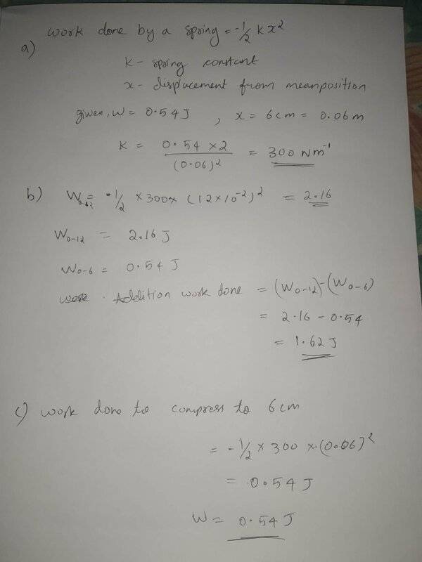

A perfectly elastic spring requires 0.54 J of work to stretch 6 cm from its equilibrium position. (a) What is its spring constant k? (b) How much work is required to stretch it an additional 6 cm? (c) How much work is required to compress the spring 6 cm from its equilibrium position?
W=1/2kx^2
I do not understand how in part a, the units for K can be N/m. If Work is in joules which is kg*m^2/s^2 and we are diving by x^2 which is m^2, then m^2 should cancel out and we should be left with kg/s^2.
Kg/s^2 makes more sense because in part b when you find the work done you are multiplying kg/s^2 * m^2 which gives you a joule.
Are the units in the work below incorrect? Or am I wrong in my explanation?
1 Newton = 1 kg m / s2 (from F = m a)
1 Newton/m = 1 kg / s2
What's your problem? Using N/m for the spring constant units conveys a more intuitive understanding of force per unit length than kg/s2.

That helps. I am not sure I just didnt correlate kg/s^2 to N/m for some reason. Your explanation makes sense. Thank you.
