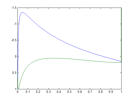

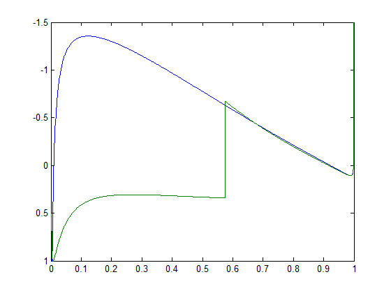

Results appear to be correct (in trend anyways) for the case when camber is
zero. But when I add camber, I am getting a discontinuity along the lower
surface. I have already set the appropriate roots of the quadratic equation
used in step 3 so the plots are using the right pieces. I can post screen shots if it helps.
I'd really appreciate a little help on this. Is this an appropriate method?
