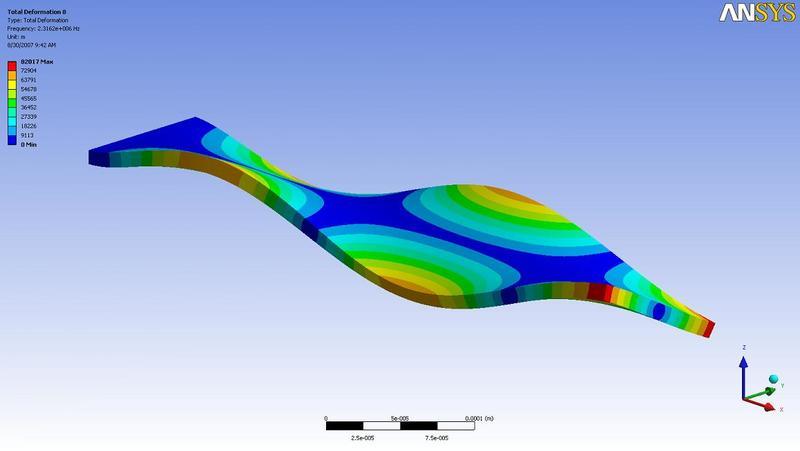

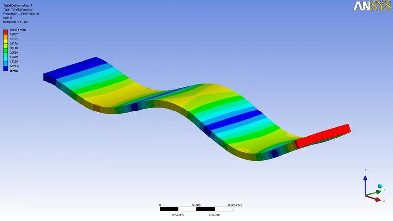

Thanks : so the beam length is 500 micrometers, 100 micrometers width and 10 micrometers thickness. It's a silicon beam. I use the default mechanical properties in COMSOL : Young Modulus = 131E9, density = 2330, poisson ration = .27. It's a clamped-free beam. And I use an arbitrary harmoni load on the upper surface. THat's all...I hope I didn't forget something...

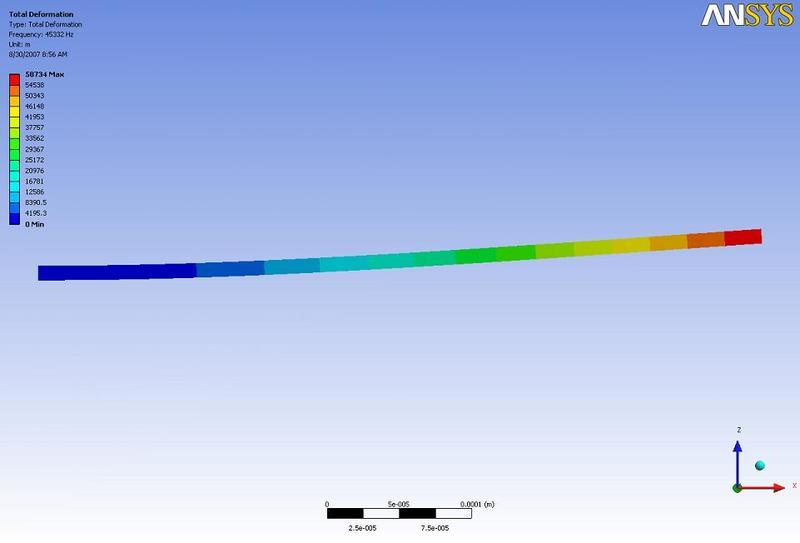

Ok did a quick modal analysis in Ansys based on the basic dimensions you gave me, and a "fixed support" on one end of the beam. As with other modal analyses, ignore the "max displacements" as they are pretty much gibberish.
Material Properties (Matweb Silicon):
http://www.matweb.com/search/SpecificMaterial.asp?bassnum=AMESi00
Young's Modulus: 112.4 GPa
Poisson's Ratio: 0.28
Density: 2329 Kg/m^3

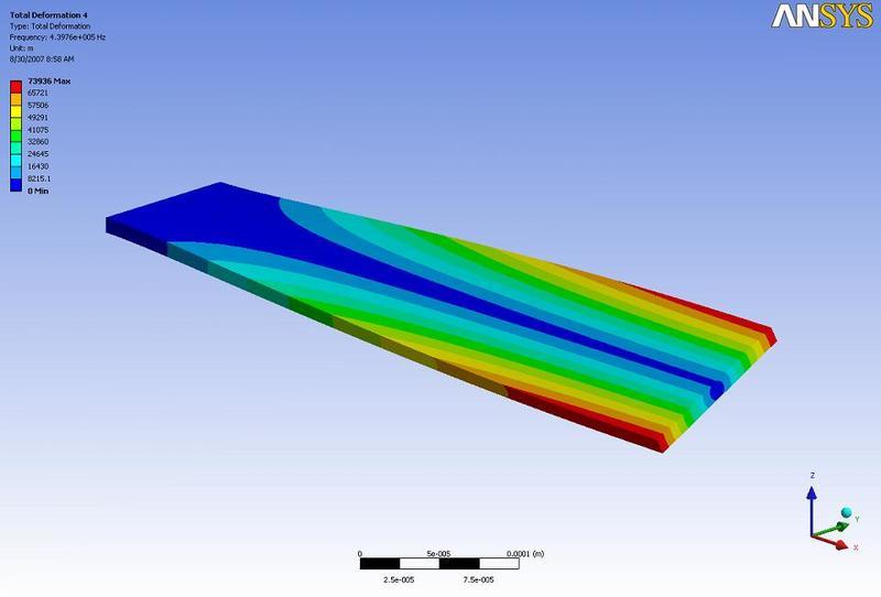

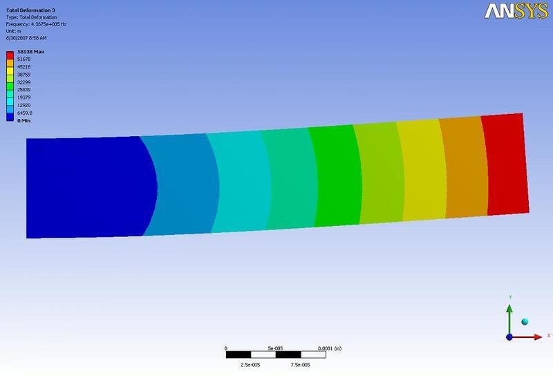

Calculated Modes:
Mode 1: 45.332 kHz
Mode 2: 283.34 kHz
Mode 3: 436.75 kHz
Mode 4: 439.76 kHz
Mode 5: 792.26 kHz
Mode 6: 1343.4 kHz
Pictures of first three modes attached, next three in next post.
Modes 4-6 pictures.

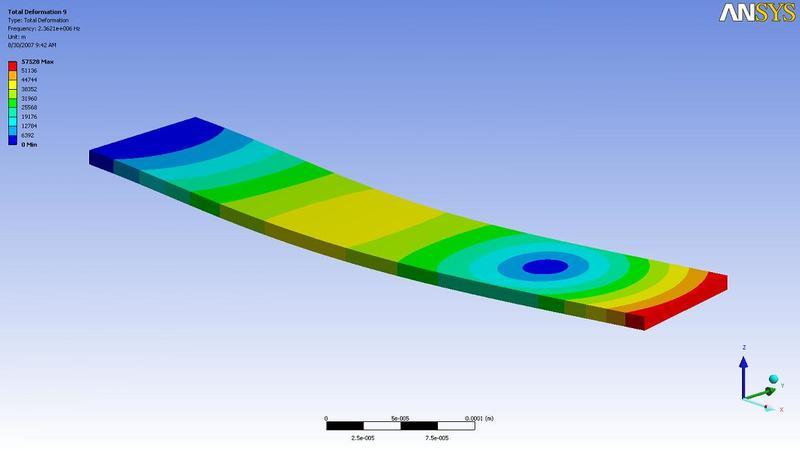

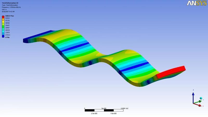

... and just for fun, modes 7, 8, 9, and 10:
Mode 7: 1549.8 kHz
Mode 8: 2316.2 kHz
Mode 9: 2362.1 kHz
Mode 10: 2554.2 kHz

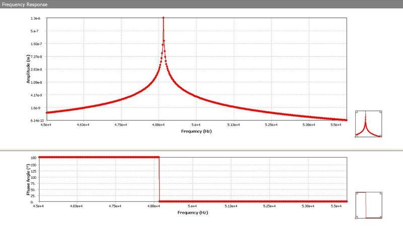

Here is the frequency respone of the beam based on a frequency acceleration (rather than a force) on the part. The calculated z-displacement is at the unconstrained end of the beam. We can see that there is a spike at the first mode.
Mode 7: 1549.8 kHz
Mode 8: 2316.2 kHz
Mode 9: 2362.1 kHz
Mode 10: 2554.2 kHz
Mode 9 at about 2.4MHz looks like an axial mode to me.
Second clue: the OP's whole response curve looks rather strange. In particular, the "resonance" at 7Mhz looks a very strange shape unless you have some exotic nonlinear damping in the model (and since damping hasn't been mentioned, I guess either you don't have any damping at all in the model, or you have a default value from the built-in material properties, not something fancy).
Third clue: The displacement scale on the OP's response plot is "times 1e-17". That's a pretty small displacement, whatever units you are working in.
My bet is, the OP applied the sinewave loading in the wrong direction. The load was axially along the beam, not nornal to it. So the bending modes never got excited at all. Plotting a displacement normal to the beam, what you see are "rounding errors" which look rather like a response curve reflected in a distorting mirror.
To the OP: try doing a linear static analysis, and compare the answers to simple beam bending theory. And compare them to the zero-frequency response in Mech Engineer's plot (post #19).

First clue:
Actually it's another bending mode in the "thick" direction of the beam. It's easier to see from the top, but I messed up in making the picture.
[Mode 1] : [Mode 2] :: [Mode 3] : [Mode 9]
