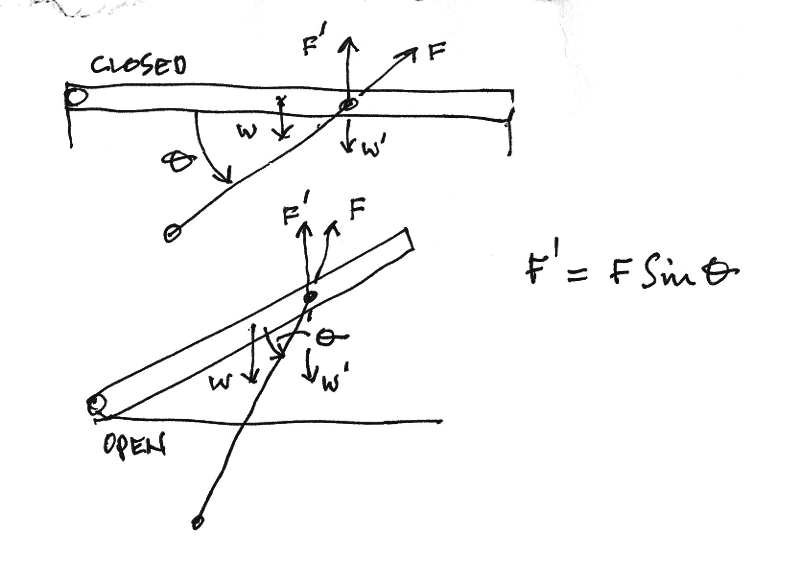

Brian,
I have knocked up a little diagram that might help, but blowed if I can see how one can attach an image...must be domestic blindness again!

You will see in the diagram attached, if my uploading works OK, I have two views, cover closed and cover open.
The gas strut force is probably given as an axial force (I haven't looked at the strut specs), hence you need the component of that force that is in the direction of the cover weight at the attachment point.
In each case the cover weight shown is W', which you need to calculate from the weight W and the location of the attachment point, noting that some weight will be carried at the hinge. You can calculate the weights (reactions) at the hinge and the attachment point using the following relationships, sum of vertical forces = zero, and sum of moments = zero. Sing out if that is foreign to you.
The gas strut axial force is F, and the component you need is F'=F.sin(theta).
As mentioned previously, play around with arc lengths equal to closed length + a bit (so it doesn't bind), and open length, from trial cover attachment points in open and closed positions.
Hope that helps

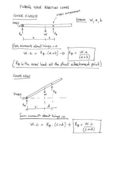

At this stage I think it is worth you having a a good try at figuring it out yourself, with a bit of guidance.
The attached gives an example of how to calculate the cover load at the strut attachment point, generalised a bit for an arbitrary attachment point. Have a think about this and see if you can use it for the case you have in mind. Just remember that a moment is force x distance, and in my examples we equate clockwise moments with anti-clockwise moments...ie they are equal if the system is in equilibrium. (sorry if this getting detailed).
See how you go, and in the meantime I'll have a bit of look at the geometry you have described and see if I can arrive at conclusions.

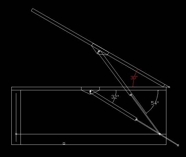

The spring lower mount is yet to be determined, just a general area, but could change. I read that if possible they should be kept at 30deg or more at the place the rest the most (closed) to insure that the oil keeps the seal lubricated fully.
I have attached another picture with a theoretical lower mounting point now for the sake of conversation and understanding.
Without regard to the formulas, my thought would be that the spring being 100% vertical would mean full spring force is lifitng the cover, and if 100% Horizontal, 0% of the force is lifting the cover (it is just pushing away from the hinge, so if it is at 45deg, then 50% of the force is against the lid.
So a 60lb cover weight with CG mounting and springs at 30deg would mean 180lbs force is needed, divided by 2 springs = 90lbs each, which would make the lid virtually weightless to lift from closed.
In my attached drawing, the angles are 32deg closed (need 168.75lbs spring force) and 54deg open (need 100lbs spring force) divide by 2 springs and need 84.375lbs force per spring. Use 80lb springs for slight lifting needed, or 90lb for self opening or close to it. 80lb springs would mean 60lbs force needed to close from open, and 90lb would mean 80lb force to close. Maybe too much? Not sure. Does this seem right?
After i post this, i will try to decipher the formulas using this latest picture, and see if i get the same thing.
Brian

at 45 deg the vertical force is 70% of axial force (sin 45).
For your arrangement as shown, at 32 deg the vertical force from struts will be 0.53 * axial force (sin 32)
At 54 deg the vertical force will be 0.81 * axial force (sin 54).
Note that if the strut force is more than the weight when open, you don't necessarily have to provide all the excess force needed at the attachment to pull the cover down. At the end of the cover furthest from hinge the force required is much less, and can be calculated by using moments about hinge.
Looks like you are getting close to having it figured out.
Cheers,
Terry

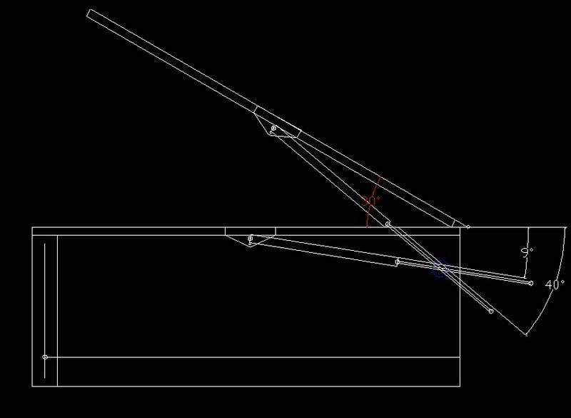

So for further confirmation and understanding here is another picture with a different lower mount with 9° closed and 40° open. Needed spring force here at closed to make cover weightless is 384, or divide by 2 springs = 192lbs each. Probably not a good plan and puts unneeded stress on the hinge and spring mounts. This is were i would want to move the upper mount out for more mechanical advantage as long as i had access to long enough gas springs.
If i have this part down, maybe i need to verify i can figure the leverage correctly if moving the upper mount, as the theoretical mounting position may not be an option, and mounting the top mount further away from the hinge may prove to be better, but ill wait for some verification that i am correct, and call it a night for now.
Thanks abunch guys i greatly appreciate your knowledge and help, and hopefully someone else will get something out of this conversation sometime as well.
Brian

Have another try at posting the picture as it will help ensure I don't misinterpret, and I'll check out the numbers.
Brian
OK, looking at this arrangement, when closed, the angle between the strut axis and the vertical is 81 deg, and the vertical component of the strut force is 0.15 (cos 81), hence total strut force required is 60/0.15=400, or 200 lbf per strut.
