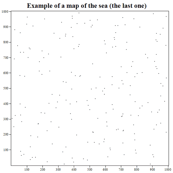

Of course, the way islands are placed in the real world is not random; it depends on the way continental plates are shaped etc. As I got home from my vacation however, I continued to think about the problem of finding the probability that islands are island best friends. I have some experience with a program called Maple, so I decided to use maple to find out about the probability that islands are best friends. I have now created a “program” in Maple that calculates this probability for randomly distributed islands on a rectangular map (grid), which easily allows the user to set the number of islands to place, the grid size and the number of simulations the program will run. Below is a sample of a map created by this program.
A map of a simulation with 200 islands, map size 1000x1000

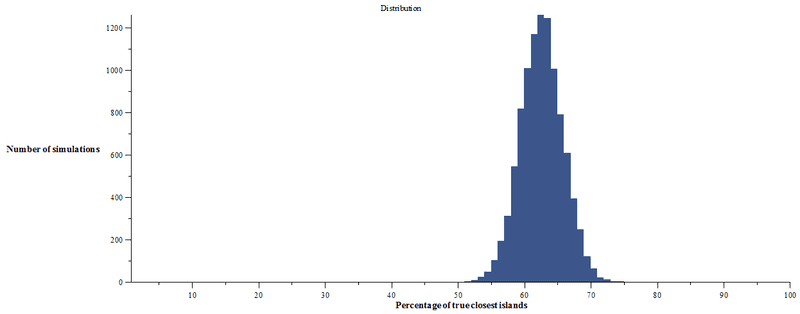

This particular map consists of 200 point-sized islands placed randomly on a 1000x1000 grid (map). The program then calculated how many of the islands have an “island best friend”. I instructed the program to run this simulation first 100, then 1000, then 10000 times. Below is a histogram showing the percentage of “island best friends” for the 10000 simulations.
Probability distribution, 200 islands, 1000x1000 grid, 10000 simulations

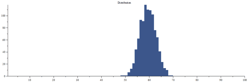

In the case of 200 point-sized islands randomly placed on a 1000x1000 grid, “the most probable probability” is that around 62-64 percent of the islands have an island best friend. Now, one might wonder how this changes when the map size is changed or the number of islands is changed. Here is one example with the same map size as before, 1000x1000, but with a 100 islands instead of 200. Shown is the result of 1000 simulations.
Probability distribution, 100 islands, 1000x1000 grid, 1000 simulations
The peaks are at about the same place, but this histogram is a little bit wider than the one with 200 islands.

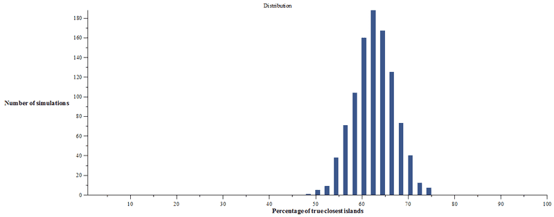

I have so far not yet have time to do a lot of calculations on the probabilities in space. Below is a distribution that shows the probability that stars will have a best friend, based on a space map of size 100x100x100, 200 stars and 1000 simulations.
Probability distribution, 200 stars, 100x100x100 grid, 1000 simulations
It’s pretty similar to the one made from 10000 simulations, 1000x1000 map with 200 islands showed earlier, except that the histogram has moved a little bit to the left. Also noteworthy is that these two configurations have the same number of possible positions for the stars/islands, namely 1 million.
