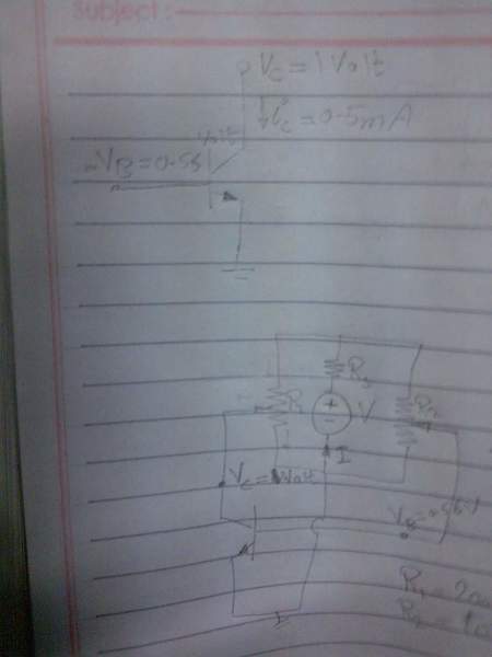

i was try to built a simple transistor circut , i chose Ic=0.5 mA , i used s8050 transistor , by looking at its datasheet i found that i ve to make Vbe=0.56 V and Vce= 1 V in order to obtain Ic=0.5mA.i used power supply with output 12 volt and max current 9 A . by using 2 plots 10k and 200k i could establish the 0.56 and 1 volts for biasing the transistor .and when i connect the transistor to the voltage terminals guess what happened ? the transistor blow up :cry::cry: ,, it toke my an hour to finish the calculation, the datasheet and the circut digram is attached pleasezzzzzzzzzzzz anyone tell my what's wrong?

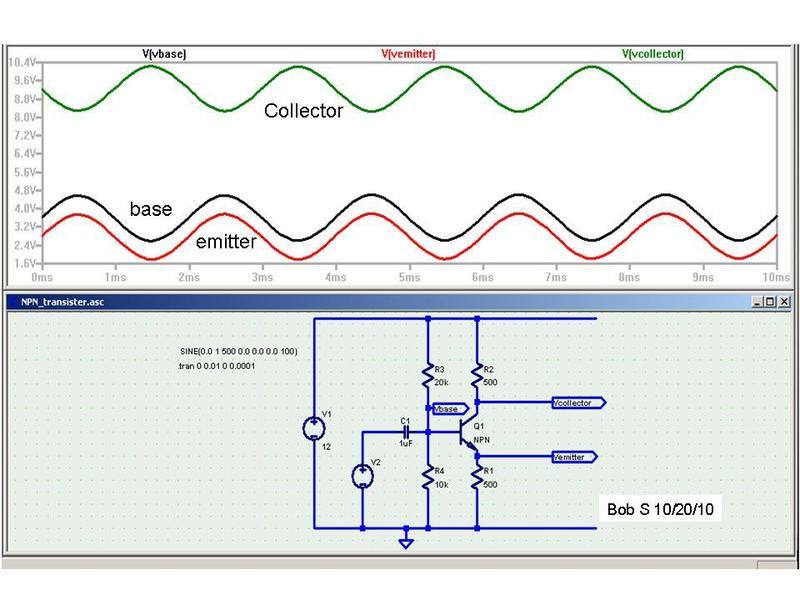

Try building the circuit in LTSpice circuit modeling application, available free for downloading at www.Linear.com;[/URL] type LTSpice in search box.

Insert a fixed emitter resistor. See thumbnail LTSpice simulation.

When you said that you "made Vbe 0.56V", how did you do that. Did you connect a power supply directly across the base-emitter junction. If so, that is why it blew up. In the forward direction, p-n junctions, such as bjt b-e junctions, LEDs, etc. must be current driven, never voltage driven. Have you had any formal education in electronics? If not, it would sure help. Please do not play with dangerous power, such as the ac mains.
Claude
What probably happened is that while you were adjusting the pots, the wipers were moved towards the + end, resulting in too much base current.
Try to work in terms of base current rather than base voltage. It is difficult to control base voltage to the necessary precision, but controlling the base current is fairly easy.
If you connect a resistor R from a + 10 V supply to the base and then have the emitter return to the - terminal of the supply, the base current is just the (supply voltage (10 V) minus 0.6 volts) / R
Suppose you want a collector current of 10 mA. The gain is about 100, so the base current is 100µA. So, the resistor reqired would be 10 volts - 0.6 volts / 0.0001 amps or 94 K. So, you could use a 100 K base resistor. You would add this as a fixed resistor, not a pot.
Now, it would be difficult for you to blow up the transistor.

tefavolc-

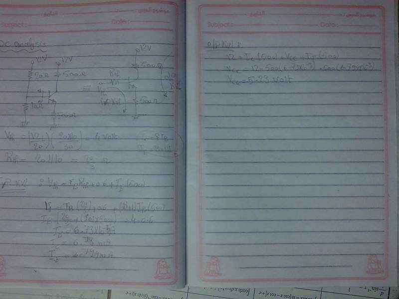

Please very carefully look at the npn circuit simulation in my post #4.
1) The base is nominally set at ~1/3 of Vcc by two resistors; a 10 k and a 20 k.
2) The 500 ohm emitter resistor determines the emitter and collector current.
3) The 500-ohm collector resistor cleverly sets the collector voltage ~half way between the emitter voltage and Vcc. This operates the transistor in the middle of the linear region.
Write down these equations, including both the Vbe voltage drop and the base current.
Bob S
Bob S
Here u are
