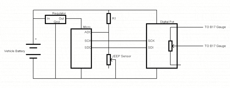

Hi All.. Scratching my head here! does anyone have a circuit solution to a project I am working on?
I have a WWII Fuel gauge out of a B-17 Bomber that will work on 12v DC, if I put 128K ohms inline the gauge reads "full" my Jeep fuel tank is 17 ohms full and 80 ohms empty. trying to create a circuit that will tie the meter into the tank sensor and read "E" when the tank is empty and "F" when its full! any ideas?

Hello,
You could do this with a very cheap microcontroller and a digital potentiometer.
A simple circuit could measure the output of the potential divider made with the Jeep fuel tank sensor and R1 (in the diagram).
The microcontroller could then calculate the resistance and output the appropriate resistance via the digital potentiometer which will be presented to the B17 gauge.
This is just an idea. If you would like some more specific information send me a message.
Nik
