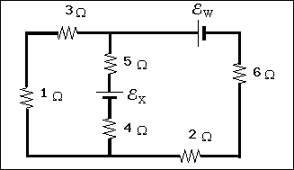

A double loop circuit is shown in the figure below.[/B]
The Emf
x = 6.00 V and the Emf
w = 19.00 V. Both are shown on the diagram. Calculate the power dissipated in the 6 Ω resistor located on the extreme right in the circuit.
V=IR, P=VI
I tried using superposition, where I replaced one battery with a short and solved for the voltage and current through the 6 ohm resistor, and the did the same by replacing the other battery with a short. The total current and voltage is the sum of the individual values. I plugged those final values into P=VI and got the wrong answer. Should this method work and I just did the work wrong or is there something I'm not aware of?
Sounds like you did it right but without your posting your work it's impossible for us to see where you might have gone wrong.
TheKShaugh said:
I tried using superposition, where I replaced one battery with a short and solved for the voltage and current through the 6 ohm resistor, and then did the same by replacing the other battery with a short. The total current and voltage is the sum of the individual values. I plugged those final values into P=VI and got the wrong answer. Should this method work and I just did the work wrong or is there something I'm not aware of?
You cannot add power by superposition. You can compute current I by superposition:
I = I1 + I2.
Then P = I^2 R.
Or you could have computed V1 and V2 by superposition, then P = VI = (V1 + V2)(V1 + V2)/R.
I = I1 + I2.
Then P = I^2 R.
DOH ! I assumed that's what he was doing but on rereading I see I just glossed over what he really said. Good catch.
