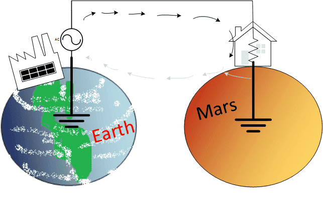

Just to make sure I'm understanding what really going on, I put together this silly example in the picture below. Ignoring the obvious physical limitation, would this concept work? If I'm understanding how Earth ground works, it seems that you could have a single conductor transmission line with a power source grounded on a large mass like Earth and a load grounded on physically separate large mass like Mars, and because both massive enough to provide a relatively neutral ground, the "circuit" would still flow?
So in other words, I guess I'm asking if the two "earth grounds" really require a path between them?
Whenever you have a “floating” conductor like this the thing to do is to connect each “floating” conductor to ground with itself capacitance. Self capacitance is the capacitance of an object with respect to a sphere of infinite radius surrounding the object. Both Earth and Mars can be considered to be capacitavely connected to this same infinite sphere.
Earth’s self capacitance is about 700 uF and Mars’ would be similar. Two 700 uF capacitors in series would give an equivalent capacitance around 350 uF.
With the resistance that would give you a RC circuit whose time constant you could calculate. But probably you would also need to include the resistance and inductance of the wire.

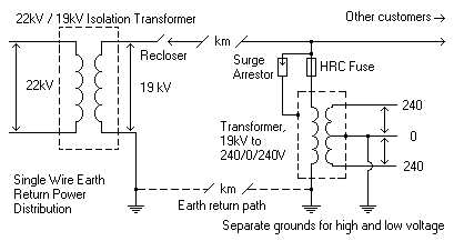

First, regarding your first sketch. There really is something called single wire Earth return power distribution. It is rare, but it does exist. See below.
https://en.wikipedia.org/wiki/Single-wire_earth_return
On the other hand do ground the wires at the customer site for safety purposes in case of accidental open or short circuited paths. But in normal circumstances and normal voltages, the Earth return path is much higher impedance than the wire return in a closed circuit. Therefore, the current going into that ground connection is nearly zero. Assume it is zero.
So yes there is such a thing as single wire Earth return power distribution, but when the return path is provided by wires (the usual case), and there are no wiring faults or errors, then the ground connections can be ignored.

What you imply in your second sketch with Mars, is that a single wire grounded at a single point, will have a huge capacitance because the planet is large. As @Dale said, there is a self capacitance of the ground and we have typical numbers for it. However, the significance of that is frequency sensitive. For DC and at power frequencies, that is negligible and we wave our hands and call it zero. In fact the rules of circuit analysis explicitly forbid consideration of charged "piling up" at any point in a circuit.
At higher frequencies, kilohertz into megahertz range, the self capacitance of a grounded point may become significant. You could slosh electrons in the ground like water in a bathtub. But at the same time, those long wires begin to act like antennas and radiate power away in all directions, and other strange effects begin to show up.

Single wire power distribution sacrifices power efficiency for the benefit of lower capital costs. Copper wire is very expensive. Places like Alaska, Brazil, Australia and New Zealand, may have customers in very remote areas who use very few kWh per month. For them, initial capital cost is more important than operating cost. The Wiki article says.
SWER also reduces the largest cost of a distribution network: the number of poles. Conventional 2-wire or 3-wire distribution lines have a higher power transfer capacity, but can require 7 poles per kilometre, with spans of 100 to 150 metres. SWER's high line voltage and low current also permits the use of low-cost galvanized steel wire (historically, No. 8 fence wire).[9] Steel's greater strength permits spans of 400 metres or more, reducing the number of poles to 2.5 per kilometre.

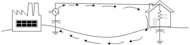

OK. So I was wondering if in general i should think of a grounding system like below, with a capacitance to ground?
Or also I was wondering given the explanation by @Dale if I should just consider both ground point as capacitivly coupled to the same imaginary infinate sphere. Even if both points are on Earth that seems like it would be a better disciption of what's happening.

As I said before, it depends on the frequency. Is your application communications? Is it power transmission at 50 or 60 Hz? Is it DC power transmission?

The Earth is big, agreed, but, as Capacitors go, it's really not that big. It's a mere 0.7milliFarads (treating it as a conducting sphere), which is a value of Capacitor that you can go to a shop and buy. 0.7mF means you can charge it up with 1Coulomb (just 1A flowing for 1s) and the Potential will increase by 1/0.7 = about 1.4V.
