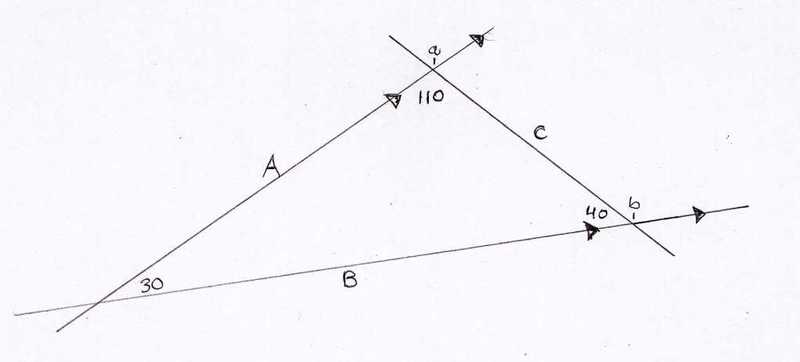

A particle travels along vector A in the direction shown and crosses vector C at point a
Another particle travels along vector B in the direction shown and crosses vector C at point b
What is the relative velocity of points a, b if the particle along vector A has a velocity
of 2 feet per second and the particle along vector B has a velocity of 3 feet per second?
(using degrees in this example)
V = VA cos 110 + VB cos 40 = 2 cos 110 + 3 cos 40 = 1.61409 feet per second
The relative velocity of points a,b can also be zero. For the above triangle, any positive velocity along vector A will have a velocity along vector B such that the relative velocity of a,b will equal zero.
Example
The particle along vector A has a velocity of 2 feet per second as it did before. What is the velocity of the particle along vector B so relative velocity of points a, b equal zero?
-2 cos 110 / cos 40 = .89295 feet per second.
so relative velocity of 2 moving points are dependant on the velocity of a particle along the vector and the angles between vectors.
Possible implications.
An observer at point b looks along vector C and notices that a certain star at point a does not have a red shift. But that star could be traveling at .2C along vector A while the observer is traveling at .089295C along vector B. Einstein did indicate that there was no absolute motion. The reasoning is that the relative velocity of objects are dependant on their vector directions as well as the velocity along the vectors.
