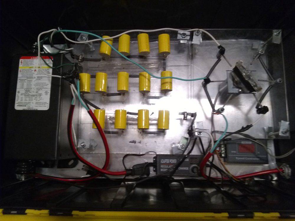

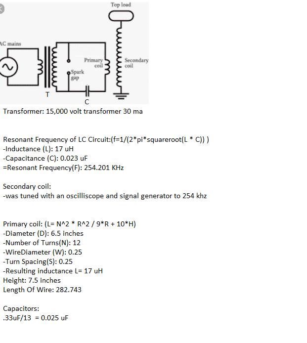

Hello I am building a Tesla Coil. I built it well I attached an image of the circuit I used. I bought a 15,000 volt transformer rated at 30 ma. I think it is too small for my tesla coil because it keeps blowing a fuses and a red light turns on. Here are the specs.
-Inductance (L): 17 uH
-Capacitance (C): 0.023 uF
-Resonant Frequency(F): 254.201 KHz
-Diameter (D): 6.5 inches
-Number of Turns(N): 12
-WireDiameter (W): 0.25
-Turn Spacing(S): 0.25
Height: 7.5 inches
Length Of Wire: 282.743
Inductance: 17 uH
.33uF/13 = 0.025 uF
2000 Volts each * 12 = 25,000 VoltsI am trying to find a formula on the internet to calculate the peak current of the entire circuit to find out how much current is going through my transformer. I have found many formulas that are very close but i just can't fully get my head around this. Here are some formulas I found.

Vrms = 15000 volts / 13 = 1,153 volts per capacitor
C = .33 uf per cap
calculate the peak current per capacitor with the above formulas, then divide the result by 13 may equal the total peak current in the circuit. That is the direction i am moving in.
This is as far as i can find. I have one string of capacitors in an mmc string. non in parallel just 13 .33 uf capacitors in a string and a 15000 volt transformer. How can i use these equations and factor in my 13 .33 uf Capacitors to find the peak Current of My tesla coil circuit. I could just buy a 60 ma transformer and i think it would work but i need to know the math before i move on because its just driving my nuts.

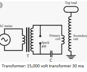

I am a student. I am working alone. I know the dangers of high voltages. I have high voltage gloves and glasses. I just recently drew up a schematic. Hope this helps.

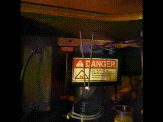

It works normally. If i hook my cap bank up in series with my spark gap, the transformer will run smoothly and the spark gap will constantly run without overloading my tranformer. Thats not how a tesla coil runs through. So i have to hook up up like the following. My t coil is hooked up like in the schematic. The transformer runs and the spark gap fires for 1 split second really loud and then the tranformer turns off and a red light glows. I checked if anything is shorting it out and I cannot find any stray metal contact or leads. There is only one alternative that the transformer cuts off when the current goes over 30 ma. I am now trying to calculate how much current is running through my LC circuit to find out how big of a transformer I need now. Thanks for the advice.

According to your schematic, the spark gap is directly across the transformer secondary.
Realize that the impedance of an arc is extremely small, putting a direct short across the transformer secondary. In fact an arc has negative resistance! This means that as the arc current increases the voltage drop across the arc declines.
The usual solution is to put some impedance (resistance) between the transformer and the arc.
An alternative solution to try would be to widen the spark gap enough that it just sparks. That should yield a sparks only near the peaks of the power line voltage, reducing the average load on the transformer. A convenient way to do that is to disconnect the capacitors and set the gap just wide enough to support a continuous arc. Then reconnect the capacitors. You may have to slightly reduce the gap with everything reconnected.
You have not told us the the current rating of the fuse that blows. Realize that the transformer is rated for 450 Watts continuous. Too start, I would use a fuse rated at least 2x the rated current... maybe even a Slo-Blo (time delay) fuse often used for motor loads. To pick a fuse rating, divide the 450 Watts by your line voltage, then double it. if the line voltage is 120V that would be:
