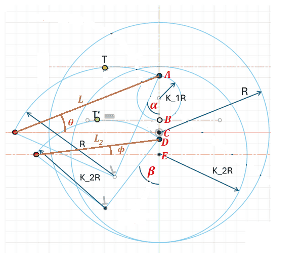

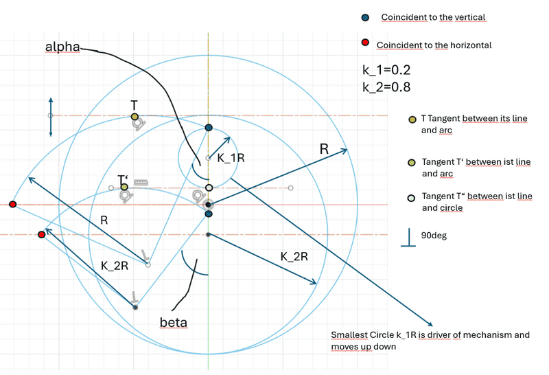

Hello All,
I struggled to find a closed form solution connecting the 2 quadrants via the angles alpha and beta. I filled the schematic with right angle triangles hoping to find a connection but to no avail.
In the end, I decided to create a polynomial function of beta in terms of alpha as I know the coordinates of the vertices. Could someone confirm that a closed form solution is not possible? Is there any way I could use a custom analytic function of beta in terms of alpha? Thanks!
I find the following relation between ##\alpha## and ##\beta##: $$\sin \beta = \frac 1 {K_2} \left( 1 - \cos \alpha + \sin \alpha \right).$$ See if you can confirm this using the method sketched below.
In the figure, ##L## and ##L_2## are the lengths of the chords of the two quadrants: ##L = \sqrt 2 R## and ##L_2 = \sqrt 2 K_2 R##.
##\theta## and ##\phi## denote the angles that the two chords make with respect to the horizontal. You can show that ##\theta = \pi/4 - \alpha## and ##\phi = \pi/4 - \beta##.
Thus, ##\sin \theta = (\cos \alpha – \sin\alpha)/\sqrt 2## and ##\sin \phi = (\cos \beta – \sin\beta)/\sqrt 2##.
##A, B, C, D, ## and ##E## label various points. Note that $$AC +CE = AB + BD +DE $$ where
##AC = L \sin \theta##
##CE = R – K_2 R##
##AB = 2K_1R##
##BD = K_2R(1-\cos \beta)##
##DE = L_2 \sin \phi##
Use these relations along with ##K_1 + K_2 = 1##.
Likes Baluncore, bugatti79 and renormalize
Hallo TSny,
Indeed the equation you derived is correct and matches the angles calculated from the program/sketch. Many thanks for your input. I neglected to consider in futher detail the segments on the vertical axis.
Much appreciated and Thanks!
