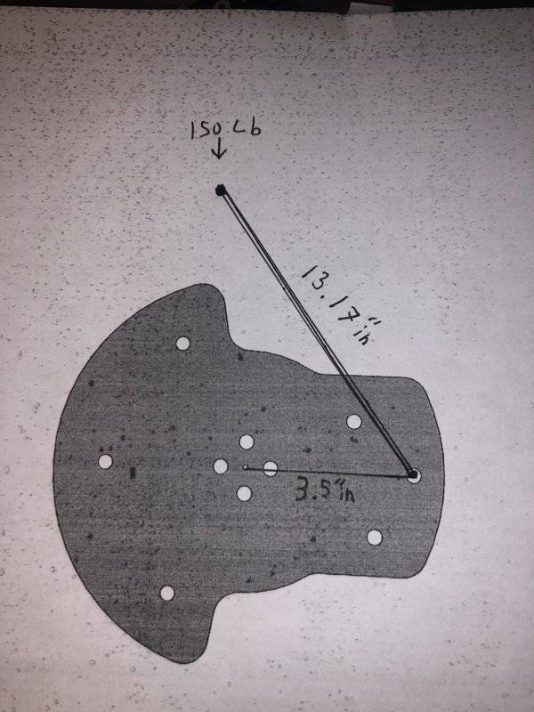

I am an artist and want to see if the motor I have selected for this mechanism will work for a project I am working on. I am trying to see if the gearbox/motor I have sourced for this mechanism is powerful enough to drive it.
The weight of the object I wish to move is 150 lbs and it moves in a completely linear motion up and down. The crankshaft is 3.5 inches from the rotation point to the bottom of the push rod and the push rod is 13.17 inches long. Attached is the power output chart for the motor and a diagram I made for my crankshaft design.
I am trying to find the torque required in in-lbs but not sure how to start.

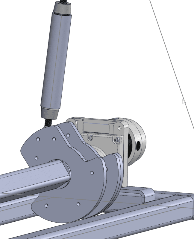

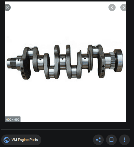

I need it to move 7 inches vertically. Crankshaft, here is a photo of what I am working on.
I think the maximum torque will be when the cam is horizontal (half-way through the lifting motion, but it's complicated a bit by how the shaft will move. Still, it's a good approximation to multiply the 3.5" length by the 150 pound load, because that shows that the current motor can't supply that torque.

The crank should not need to lift the entire mass.
Can you increase the crank counterweights ?
Can you include a spring somewhere that supports half the weight ?

What guides the 150-lb object linearly up and down?
What is the approximate weight of the con-rod?
Is there considerable sliding friction to consider?
Any requirements for starting rotation up's?
The main torque requirement comes in this case from the inertial resistance of the 150-lb object plus con-rod to accelerate and decelerate 400 times per minute or 6.7 times per second.
Just a back-of-the-envelope estimate here. If I'm all wet, I'm sure others here will make the needed corrections. :wink:
Please consider:
Changing direction that rapidly is around 2g, g being the acceleration of gravity. That shows the force pushing the weight up will be in the neighborhood of 450lbs... along with a 150lb force needed to pull it down fast enough.
Converting to inch-lbs as you asked is:
3.5 x 450 = 1575in-lb
Also, since the weight has to be pulled down with 150lbs, your motor/crank better be securely fastened down.
With a cyclic load on the connecting rod bearings, crankshaft bearings, and the sideways force on the weight, design by a mechanical engineer is strongly recommended.

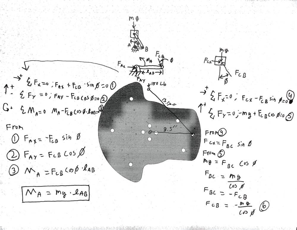

A 4 bar mechanism guides the object up and down, I can add more weight to the end of the counterweights of the crankshaft. Cool, I did some sleuthing on my own and am also getting a ~similar force, solving I get 525 in-lb but yea, forgot about the acceleration in terms of direction, opps.

OK, we match on the 525in-lb. That's what I got before the acceleration. :oldbiggrin:
But I did forget the angle between crank and connecting rod. About 1/4 of the force generated by the crank will try to move the connecting rod to the left in the drawing, leaving 75% as lifting force.
1575 / 0.75 = 2100in-lb
Plus friction, plus safety factor, plus x4 (at least) since you will be reversing the motor every quarter turn.
Can you put the crank on the unsupported end of the shaft? That will allow continuous motor rotation and reduce the crank throw by half, which also reduces the torque by half and increases bearing lifetime.
