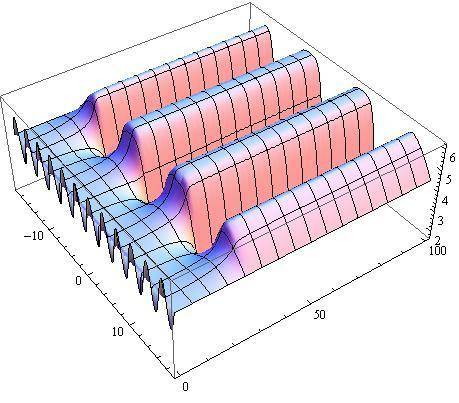

With that in mind, I'd like to scale-back my attempt at this with a 1-D model:[tex]\frac{\partial u}{\partial t}=8 \frac{\partial^2 u}{\partial x^2}+4.5-(b+1)u+u^2 v[/tex]
[tex]\frac{\partial v}{\partial t}=16 \frac{\partial^2 v}{\partial x^2}+bu-u^2v[/tex]
with [itex]b_c\approx 17.5[/itex]
Also, I'm beginning to believe the boundary conditions are not so important so in my first attempt to better understand this system below, I keep the boundaries at the equilibrium points [itex]u_0=a[/itex] and [itex]v_0=b/a[/itex]. For the initial conditions, I just use a sine wave oscillating around the equilibrium points of both u and v:
Code:
myDu = 8;
myDv = 16;
a = 4.5;
bcrit = (1 + a*Sqrt[myDu/myDv])^2
b = 17;
xmin = -6*Pi;
xmax = 6*Pi;
tmax = 100;
u0 = a;
v0 = b/a;
myBrusselator = NDSolve[{D[u[x, t], t] == myDu*D[u[x, t], x, x] +
      a - (b + 1)*u[x, t] + u[x, t]^2*v[x, t],
    D[v[x, t], t] == myDv*D[v[x, t], x, x] + b*u[x, t] -
      u[x, t]^2*v[x, t], u[x, 0] == a + Sin[2*x], u[xmin, t] == a,
    u[xmax, t] == a, v[x, 0] == b/a + Sin[2*x], v[xmin, t] == b/a,
    v[xmax, t] == b/a}, {u, v}, {x, xmin, xmax}, {t, 0, tmax},
   MaxStepSize -> 0.1]
Plot3D[u[x, t] /. myBrusselator, {x, xmin, xmax}, {t, 0, tmax},
  PlotRange -> All, PlotPoints -> 50]
In the first u-plot below, b=17, just below the bifurcation point. Note how the sine-wave perturbation is quickly quenched as the value of u(x,t) returns to it's equilibrium point a=4.5. In the second plot I set b=18, just above the critical point and note how u(x,t) settles into a new state although at this point I don't know if u(x,t) would eventually return to it's equilibrium point at u(x,t)=4.5.

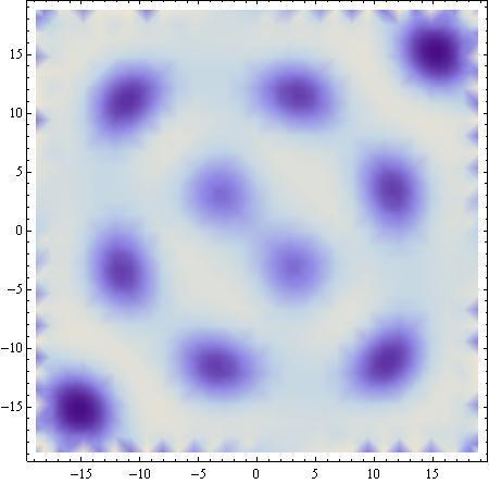

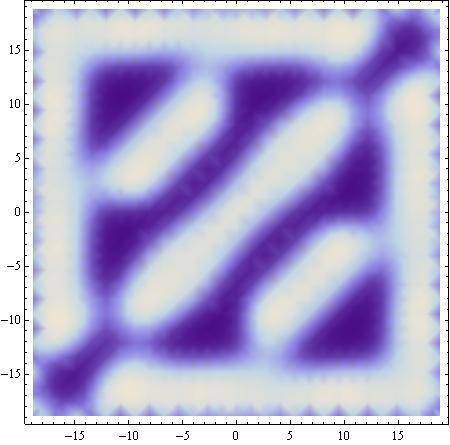

Here's my second attempt at a 2D model using Mathematica and I stress that to really grasp this thing, I really should be focusing on the underlying dynamics but for now, just kinda' playing around with it:
[tex]
\frac{\partial u}{\partial t}=5\left(\frac{\partial^2 u}{\partial x^2}+\frac{\partial^2 u}{\partial y^2}\right)+3-(b+1)u+u^2 v,\quad -6\pi\leq \{x,y\}\leq 6\pi,\quad 0\leq t\leq 10
[/tex]
[tex]
\frac{\partial v}{\partial t}=12\left(\frac{\partial^2 v}{\partial x^2}+\frac{\partial^2 v}{\partial y^2}\right)+bu-u^2v
[/tex]
[tex]\begin{align*}
u(x,y,0)&=a+\sin(x y)&\quad v(x,y,0)&=b/a+\sin(x y) \\
u(-6\pi,y,t)&=a+\sin(-6\pi y) &\quad v(-6\pi,y,t)&=b/a+\sin(-6\pi y)
u(6\pi,y,t)&=a+\sin(6\pi y) &\quad v(6\pi,y,t)&=b/a+\sin(6\pi y)\\
u(x,-6\pi,t)&=a+\sin(-6\pi x) &\quad v(x,-6\pi,t)&=b/a+\sin(-6\pi x)\\
u(x,6\pi,t)&=a+\sin(6\pi x) &\quad v(x,6\pi,t)&=b/a+\sin(6\pi x)
\end{align*}
[/tex]
Then [itex]b_c\approx 8.6[/itex]
In the first density plot of u(x,y,10) below, b=9. In the second density plot of u(x,y,10), b=12 using the following code although Mathematica had difficulty generating all this data.

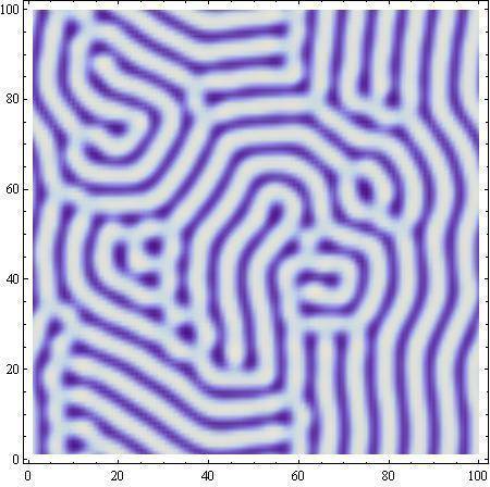

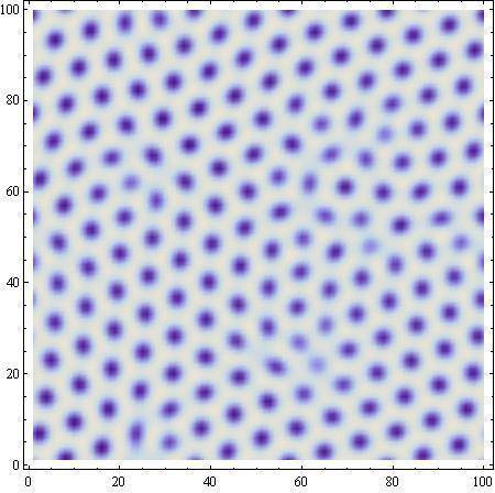

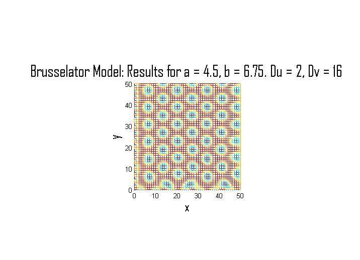

I decided to resort to (direct) finite differences to help run this brusselator since Mathematica's NDSolve runs into problems primarily because it saves all the interim iterations which quickly exhaust memory for any decent run. Maybe there is a way to avoid that but I don't know how at present. With that in mind, I contacted Teemu Leppanen, the author of the exercise I cited above, and received the C source code. After I made the required modifications and edited the output file to be compatable with Mathematica's list format, I used ListDensityPlot and I was able to finally achieve what I would consider some resolution to this problem in the form of brusselator stripes and dots. The parameters I used was:
a=4.5
b=6.75 (stripes), 7.5 (dots)
D_u=2
D_v=16
and I ran the simulator 50,000 iterations to obtain the plots below.
RoastedWater, if you're still interested, I can help you edit Teemu's code to obtain the results above but maybe you've moved on. Anyway, it was a fun problem for me as I've been interested in biological evolution for a very long time. :)

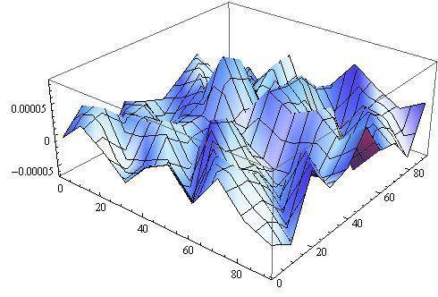

Ok. Good you got the results you were looking for. Maybe I have the stripes and spots reversed. I barely have a handle on this at present but plan to work on it more. Also, I'm interested in verifying the results. How do we know after 50 thousand Euler iterations, the final results satisfy the PDE? I know we get results qualitatively similar to published results but how do we know those results accurately reflect the evolution of these equations? In Mathematica, it's very easy to back-substitute NDSolve data into the PDE and directly verify the results. May take a little more effort to do so with the Teemu data. I'll try and figure out how to do that and plot the discrepancy.
ah.. that's an interesting question. i think since the finite difference scheme is stable, there would be an error but it will still largely satisfy the original pdes, the stability condition being D*ht/hx/hx being less that 0.25. this can vary with the boundary conditions but for this set of boundary conditions it stable. of course stability does not guarantee accuracy but it shows that the solution has a good chance of being accurate. but then again, these are first order methods and the errors would be larger than say a second or a third order scheme. infact, the book, numerical recipes by teukolsky warns that programmers resorting to higher order methods may not always get accurate results as this might introduce errors in the form of oscillations resulting from higher harmonics.
I stored a range of (time) iterates for both u and v so that I can back-substitute the solution into the PDE system. I ran the simulation and waited for the last 10 iterates. Since dt=0.01 in this particular run and I ran 5000 iterates, I saved a time slice from 49.90 to 49.99. I then ran InterpolationFunction on both the u data and v data at t=49.95, and computed mydifFunction=(lhs-rhs) of the first PDE and plotted the results. The plot below suggests the results are accurate to about 5 decimal places although I'm not yet quite confident of this.
Code:
myuData = << "c:\\Documents and \
Settings\\Owner\\My \
Documents\\ufile.dat";
myvData = << "c:\\Documents and \
Documents\\vfile.dat";
myu = Interpolation[myuData]
myv = Interpolation[myvData]
aval = 4.5;
bval = 6.75;
mydifFunction[x2_, y2_] :=
  D[myu[x, y, t], t] -
    2*(D[myu[x, y, t], x, x] +
      D[myu[x, y, t], y, y]) - aval +
    (bval + 1)*myu[x, y, t] -
    myu[x, y, t]^2*myv[x, y, t] /.
   {x -> x2, y -> y2, t -> 49.95}
mydifTable = Table[{xval, yval,
     Evaluate[mydifFunction[xval,
       yval]]}, {xval, 1, 99, 10},
    {yval, 1, 99, 10}];
ListPlot3D[Flatten[mydifTable, 1],
  PlotRange -> All]

I'd like if I may, post a description of the Mathematica code I used to generate the Turing patterns above with a little bit of explanation:
We study:
$$\frac{\partial u}{\partial t}=A+(B-1)u+u^2 v+D_u \left(\frac{\partial^2 u}{\partial x^2}+\frac{\partial ^2 u}{\partial y^2}\right)=F(u,v,\nabla_u^2)$$
$$\frac{\partial v}{\partial t}=bu-u^2 v+D_v \left(\frac{\partial^2 v}{\partial x^2}+\frac{\partial ^2 v}{\partial y^2}\right)=G(u,v,\nabla_v^2)$$
with periodic boundary conditions, that is, over a torus. We use Euler's method:
$$u_{i+1}=u_i+\Delta t F(u_i,v_i,\nabla_{u_i}^2)$$
$$v_{i+1}=v_i+\Delta t G(u_i,v_i,\nabla_{v_i}^2)$$
which for stability reasons we let [itex]\Delta x=\Delta y=1[/itex]. See VonNeumann stability analysis for more info about this: http://en.wikipedia.org/wiki/Von_Neumann_stability_analysis).
The initial values for u(x,y,0) and v(x,y,0) are random points. For example, u is initialized with the code:
[tex]u=a+0.3*\text{RandomReal}[\{-0.5,0.5\},\{n,n\}][/tex]
For example, use a rectangular grid 64x64 and allow the edges to ``wrap around'', that is the last column of the array has for computational purposes, on it's right side, the first column of the array and likewise, the last row of the array has below it, the first row of the array, then we can implement the periodic boundary conditions. With a little work studying the RotateLeft and RotateRight functions in Mathematica, it's not difficult to show the forward-difference approximation for [itex]\nabla_u^2[/itex] with this ``wrap-around'' geometry is:
[tex]\text{RotateLeft}[u,\{1,0\}]+\text{RotateLeft}[u,\{0,1\}]+\text{RotateRight}[u,\{1,0\}]+\text{RotateRight}[u,\{0,1\}]-4*u[/tex]
In the code below, the variables u and v are 2D arrays so all the arithmetic is being done in array arithmetic. Anyone interested should be able to simply cut-and-paste the code into Mathematica.
Code:
n = 64;
a = 4.5;
(* b=7.5 for stripes and 6.75 for dots *)
b = 7.5;
du = 2;
dv = 16;
dt = 0.01;
totaliter = 10000;
u = a + 0.3*RandomReal[{-0.5, 0.5}, {n, n}];
v = b/a + 0.3*RandomReal[{-0.5, 0.5}, {n, n}];
cf = Compile[{{uIn, _Real, 2}, {vIn, _Real, 2}, {aIn, _Real}, {bIn, _Real}, {duIn, _Real},
     {dvIn, _Real}, {dtIn, _Real}, {iterationsIn, _Integer}},
    Block[{u = uIn, v = vIn, lap, dt = dtIn, k = bIn + 1,
      kern = N[{{0, 1, 0}, {1, -4, 1}, {0, 1, 0}}], du = duIn, dv = dvIn},
     Do[lap = RotateLeft[u, {1, 0}] + RotateLeft[u, {0, 1}] + RotateRight[u, {1, 0}] +
          RotateRight[u, {0, 1}] - 4*u; u = u + dt*(du*lap + a - u*(k - v*u));
        lap = RotateLeft[v, {1, 0}] + RotateLeft[v, {0, 1}] + RotateRight[v, {1, 0}] +
          RotateRight[v, {0, 1}] - 4*v; v = v + dt*(dv*lap + u*(b - v*u)); , {iterationsIn}];
      {u, v}]];
Timing[c1 = cf[u, v, a, b, du, dv, dt, totaliter]; ]
ListDensityPlot[c1[[1]]]
